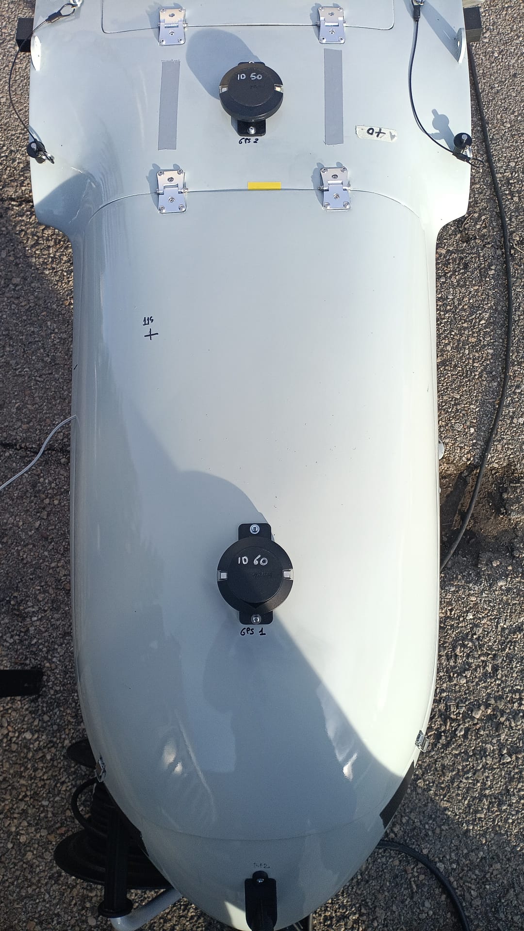

Hello, because i have big VTOL with big motors, i have many EM Electromagnetic interferences and make crazy magnetometer and compass i need to set baseline yaw.
we try many many times and read manuals, documents, forum but still not work

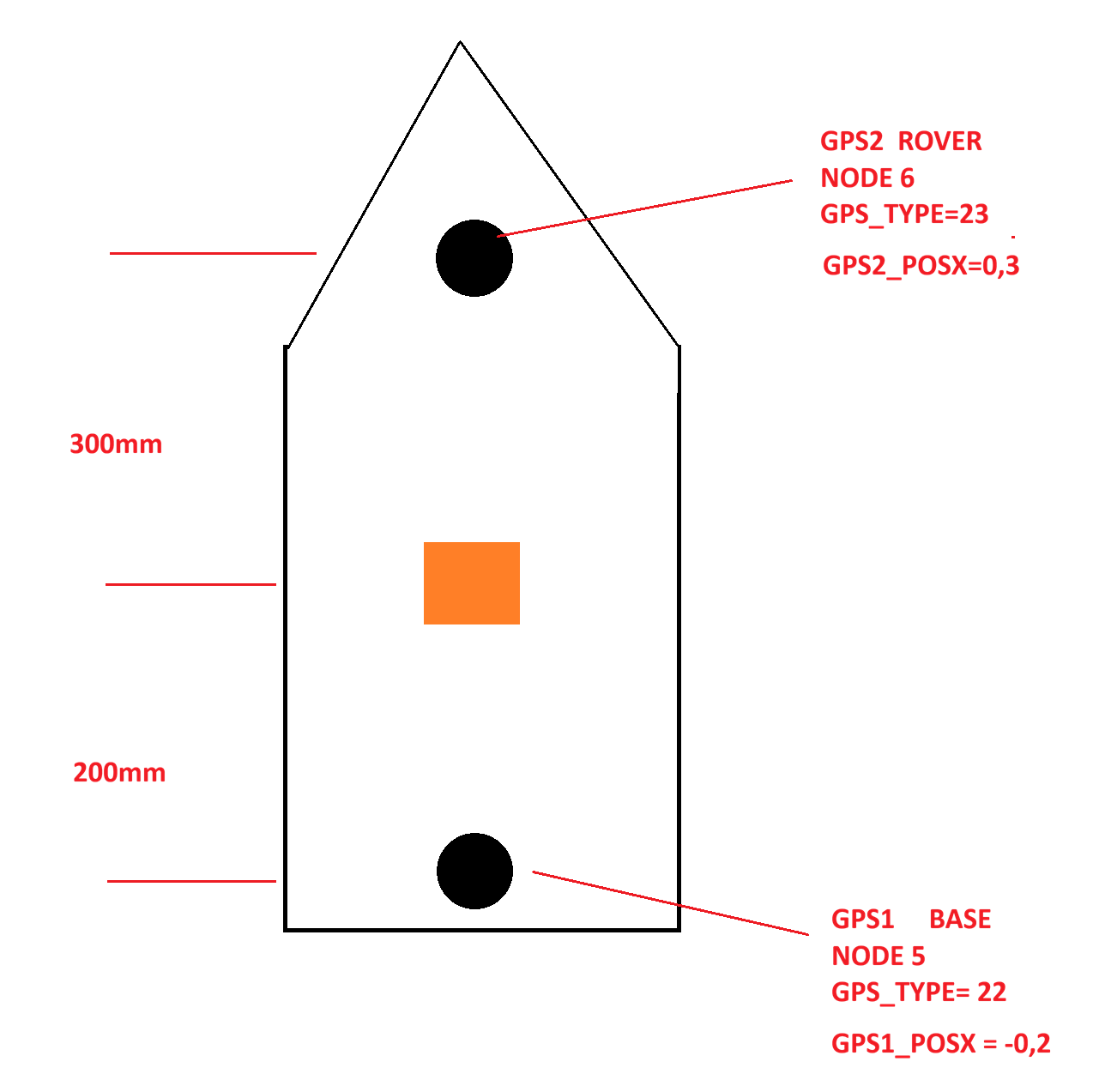

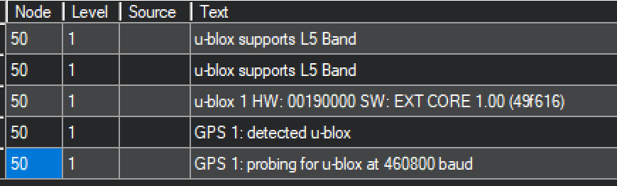

i have RTK FLOAT in one GPS and second 3dgps with always this error: **GPS[2] yaw not available
we have try reverse NODE ID or POSITION or BASE AND ROVER but still not work
after one week of try and many engineers
