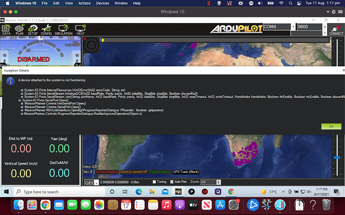

Ok so i have tried to connect to it on both can ports and now if it shows up in mission planner slcan mode it can’t talk to it. It just seems to get a report and then not talk anymore, no logs, no parameters and no uptime counter.
Since i can’t connect to it it won’t update nor can i update the firmware in u center as ucenter won’t connect to it either

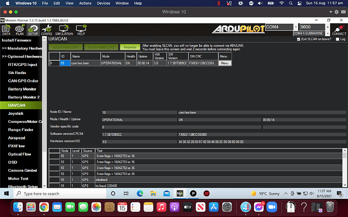

OK so after reseting around 10 times it finally started doing what it should be doing and i managed to update both through mission planner and through u center and now it recognises it and cannot get a signal, it just says unhealthy gps signal and no fix no matter where i am.
I noticed after i updated it that there are some raw flags could that be why? here is a screen shot

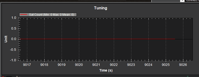

While your autopilot is connected to Mission Planner, open and double click the tuning screen. Select satcount.
Do you see any values?

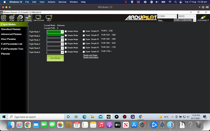

When i open the config menu item i don’t have an option for tuning nor do i have any flight mode options. see screen shots. Is that normal? i fell like it’s not.
OK just loaded quadcopter firmware and now everything seems to work. Is it a problem with the ardupilot sub firmware do you reckon?
Maybe you were not using the latest firmware to update the Here3. There was some problems in CAN in older firmware.
