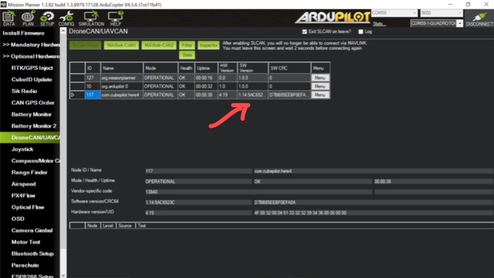

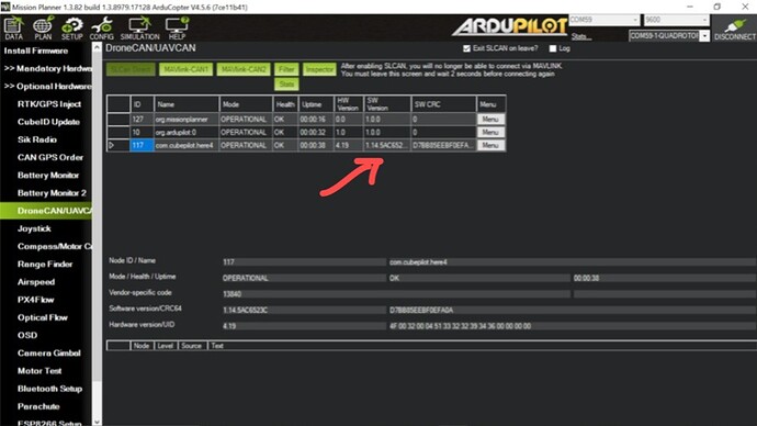

Here 4 (HX4-06248-25300549)
Firmware (1.14.5AC6523C)
Total sats count 30-32

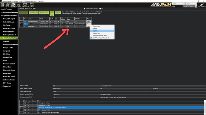

Here 4 (HX4-06248-24803006)
Firmware (1.14.2DE07E)
Total sats count 4-12
1 hour to get fix

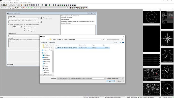

for bad Here 4 (HX4-06248-24803006), i was try to upgrade the Ublox firmware but still cannot fixed yet. if you have similar problem please share the solution, thank you.

I also noticed that the Here4 firmware before the update was 1.14.5A.C6523C; after the update, it changed to 1.14.2DE07E. Is that correct? Did it downgrade?

we update it from mission planner directly, we cant pick which the firmware because it automatically update to the latest version.
