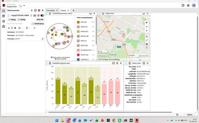

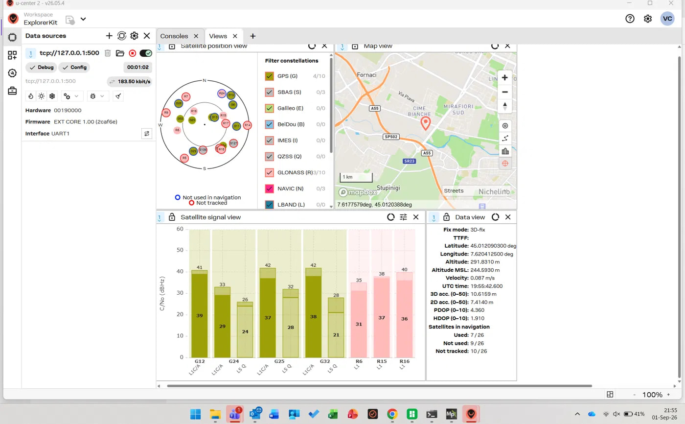

Although in u-center I see the satellites and geographical coordinates correctly:

Summary of what we tried so far: Here4 (node 125, GNSSPeriph 1.15.309D03B7, HW 4.19) on a Cube Orange+ running ArduPilot 4.7.0 never delivers a fix to the autopilot — GPS1 reports fix_type=1, sats=0, hdop=655.5 indefinitely — because the module’s own AP_Periph GPS driver is stuck in a loop: it probes the internal u-blox at 230400 baud, receives the version reply (EXT CORE 1.00 (2caf6e)) 0.6 s later, then gets no navigation output and no acknowledgement of any configuration command, times out after 4 s with gnss.Status healthy=false and error_codes=24575 (14 config items unacknowledged), and restarts exactly 13.6 s later. The receiver itself is fine: through the CAN passthrough, u-center gets a clean 3D fix from it with 7 satellites used of 26 tracked, HDOP 1.91 and C/N0 of 41–42 dBHz on both L1 and L5. We have ruled out the autopilot (three Cube Orange+ boards, GPS and CAN parameters verified identical), the CAN bus (zero rx errors and zero bus-off across 85 000+ frames, terminator enabled, static node ID 125), the DroneCAN node itself (OPERATIONAL, health OK, uptime monotonic with no reboots, and its RM3100 compass streaming flawlessly throughout), the GNSSPeriph firmware (reflashed to 1.15) and sky view (tested outdoors with no change). So this is not a hardware or bus fault but a failure of the configuration handshake between AP_Periph and the F9P — the receiver answers MON-VER but ignores every CFG message — which we suspect may relate to the u-blox firmware build, since ours reads 2caf6e where CubePilot’s documentation references 49f616.

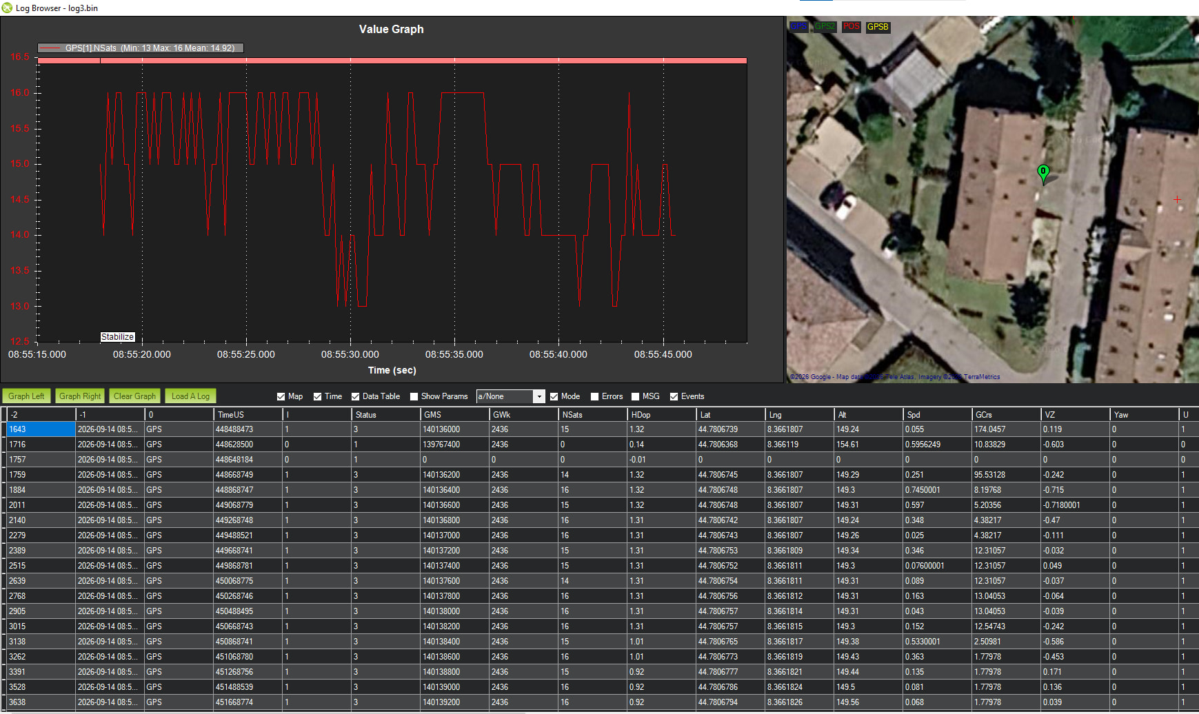

Looks like it is working:
Thank you for looking at the log. I think there’s been a mix-up: the graph shows GPS[1] NSats, and GPS[1] in the log’s zero-based indexing is the second GPS instance — my Flywoo GOKU GM10 Mini V3 (u-blox M10050, single-band L1) on SERIAL3, which I keep as a fallback. It appears in the log as u-blox 2 HW: 000A0000 SW: ROM SPG 5.10; generation-10 hardware confirms it is the M10, not the Here4’s F9P (generation 9, HW: 00190000).
The Here4 is GPS[0], and in the same log it reads Status=1 (NO_FIX), NSats=0, Lat/Lng=0.0000000 on every one of its samples. The log also shows error changed (0x00005FFF/0x00000000) toggling on that instance, with CAN[125] GPS 1: probing for u-blox at 230400 baud and GPS 1: detected DroneCAN1-125 repeating — 0x5FFF is 24575, the u-blox driver’s 14 unacknowledged configuration items.
I should also note that no RTK base station was connected for this test, so no receiver in this log could have produced an RTK solution regardless. My issue is more basic: the Here4 does not acquire any satellites at all.
Could you re-check using GPS[0]?
