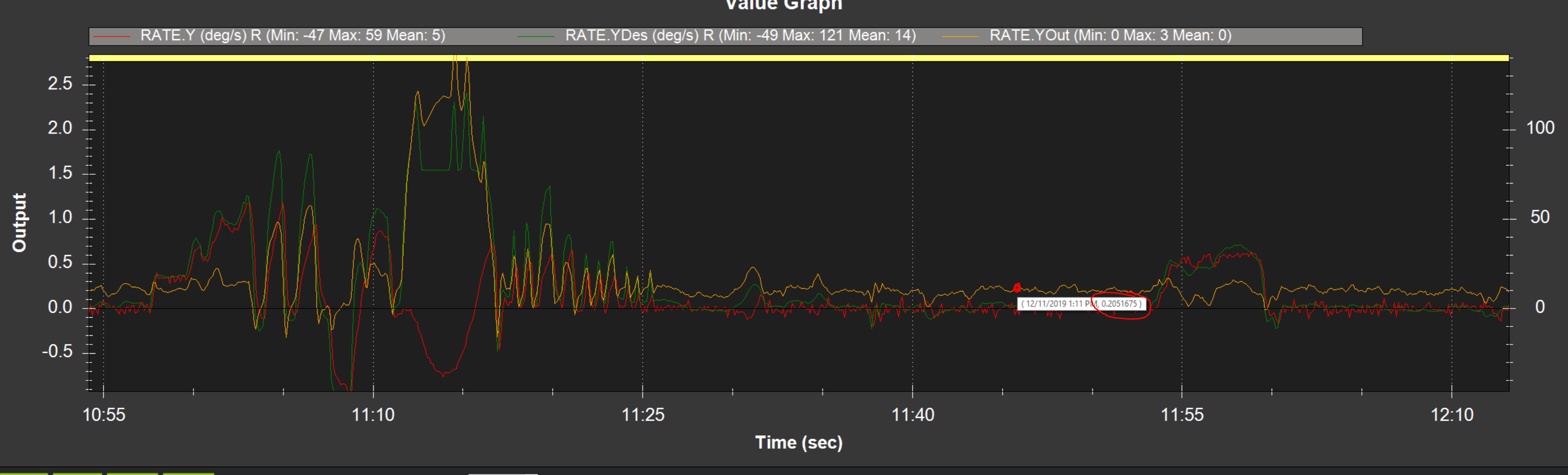

I was trying an Hexa I build, and I have notice sometimes the yaw doesnt respond, I have to move the stick to another side to recover the control.
Here is the log, as you can see the FC want to rotate, but there is no movement.

The drone was unable to match your command:
This is because your drone has a severe left-yaw bias:
The flight controller is constantly commanding a 20% effort right yaw in order to maintain heading. The rate outputs should be centered around 0 in a stable hover without wind.

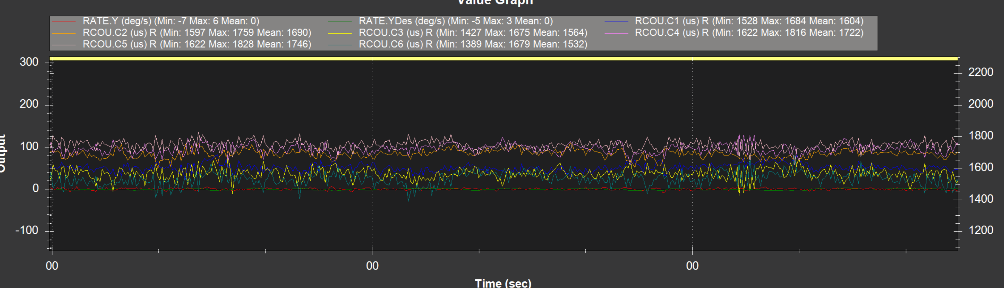

This is also visible in your motor output balance:
For yaw, a 20% bias is pretty severe. This is almost always caused by a motor arm or motor mount being twisted.
