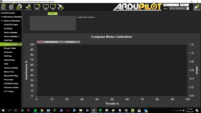

Did you do the CompassMotor calibration?
