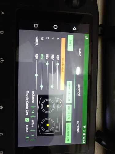

I couldn’t detect radio channels and even QGC will say radio calibration issues and buttons not mapped.
You need to click HW JS calibration. Then follow that then do the wheel and you must click save once done.

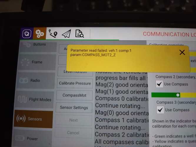

thanks for solution but after update i’m facing another problem i.e. missing params:1:compass_primary
There has been changes to the whole compass setup in Ardupilot. I would set that element up in mission planner and ignore the messages in QGC as this will be fixed in future updates.

having problem like ekf variance and compass_mot2_z
Can you try to calibrate in Mission Planner and see if this message will still pop up?

Herelink uses sbus for remote control, therefore you can calibrate RC in Mission Planner
Hovering at zero throttle or not has nothing to do with able to calibrate in MP or not.
