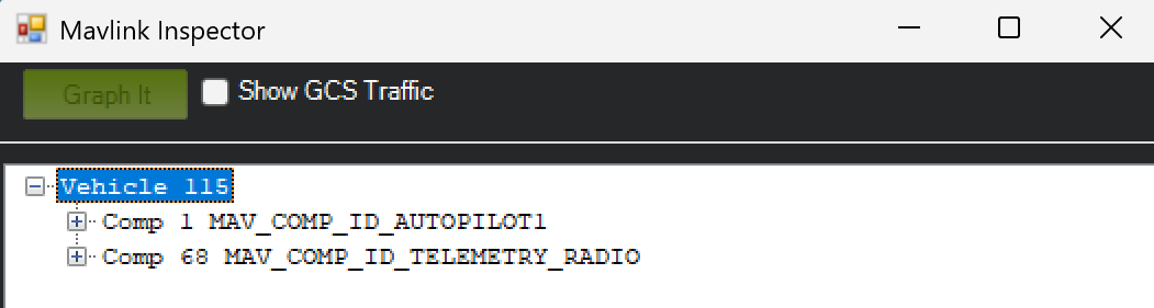

I don’t see any planes in the sky. I saw that you can check the heartbeat of the ADSB receiver in Mission Planner by going into Setup → Advanced → Mavlink Inspector
It should show a comp0 value, but I don’t have that.

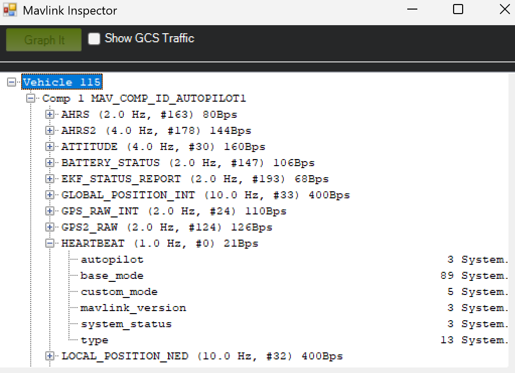

I think it may have changed to have a different comp number. I do see this heartbeat value
I don’t know if this is the ADSB or something else.
