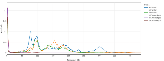

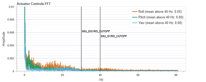

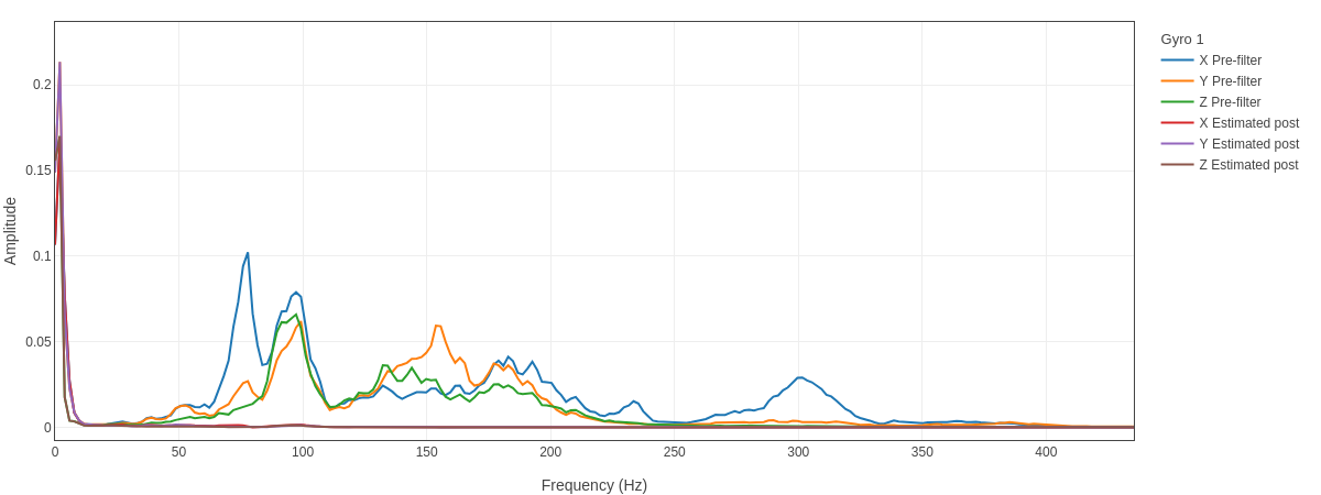

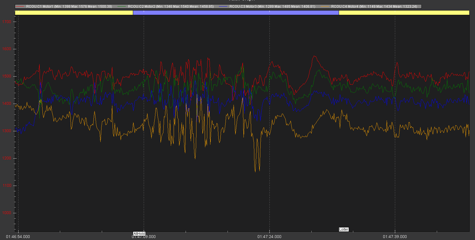

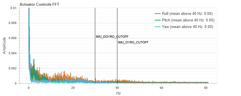

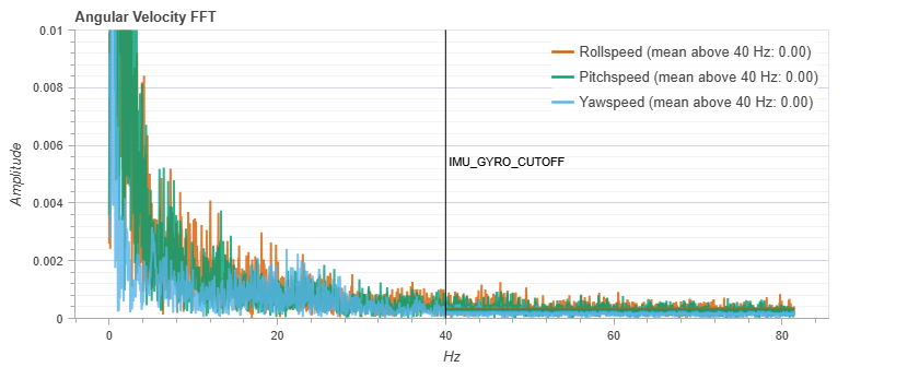

Can you let me know what you think of these two pics?

Hi Paul,
I’m really not sure what to make of those graphs - they seem to be indicating very low levels of noise. It probably depends a lot on what you are trying to find.
You can definitely disable the notch filter entirely. There is practically no noise getting past the gyro filter.
In this graph the pre-filter noise only needs any treatment IF it gets through to post-filter. With the harmonic notch filter “less is more” and we should not use any more filtering or features than absolutely necessary.

INS_HNTCH_ENABLE,0
INS_LOG_BAT_MASK,0
INS_LOG_BAT_OPT,0
I think the problem causing that spread of noise (instead of distinct peaks) and the altitude issues is probably some frame twist or motor mount twist. The CCW motors are working slightly harder than the CW motors to correct for some physical yaw bias.
It looks like a section of oscillating outputs in AltHold in this graph, however that is commanded pitch and roll - so that’s nothing to worry about.
Since attitude control is actually quite good regardless of the spread of motor outputs, I’m certain that fixing that motor mount twist will make good progress to fixing the altitude issue too. If you can nail that down Autotune of all axis’ would make good improvements.
You can set PSC_ACCZ_P,0.2 and that will help out the altitude issue once the motor outputs are pulled into line and motors stop fighting each other.
In other news, try GPS_AUTO_CONFIG,2 to get the GPS update rate more stable. It’s already doing better by selecting less constellations than earlier. There is a nice stable HDOP.

In this comment, “I think the problem causing that spread of noise (instead of distinct peaks) and the altitude issues is probably some frame twist or motor mount twist.” The airframe is rigid, with no twisting, but I have 2.5-3 degrees of motor twist.
The CCW motors have -3.0deg and CW are + 3.0 deg. maybe that is way to much?
Thank you for your input again. I will make those changes and test fly again. I will post the logs asap. If you see my other post, I wonder if my motor angle is too much or in the wrong direction… good observation.
