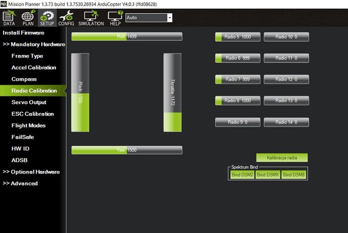

I use Pixhawk Cube-orange with Arducopter 4.0.3 frame type: quadro X.
I would like use AUX (1-6) as RC channels (RC9-RC14). In status window
chin9 - chin14 is pwm level 0 despite from Radio is signal 1000-2000us.
How solve this problem??

Thanks for answer:) I tried it with different number settings ( 4 ,5 ,6,7…14) but still
chin 9-14 is 0 level.
screen:

I made settings Servo_9 Function for RCIN 8 and it works but for RCIN9-14 still not.
Why pixhawk don;t see RC9 and RC 10 input from RC receiver?
Are you able to see those rcin channels from the rc calibration in Mission Planner?
I still don’t see RC 9-RC 10. I have Flysky FS-IA10B 10 channel Receiver.
Why pixhawk don;t see RC9 and RC10?
Thanks:)
Can you verify that your transmitter is sending on those channels?
