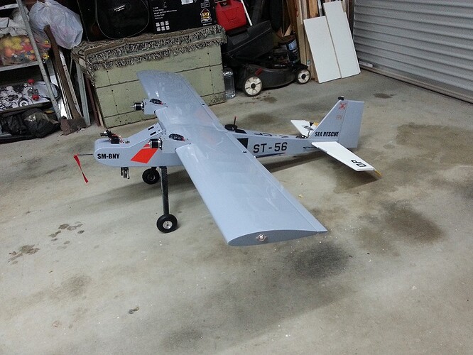

Autoland stall in 10KT head winds
Hi all in auto land plane does the cube use the airspeed sensor and the gps speed ?
i had a plane stall drop in 10KT winds ?
looking at the logs there was 10KT difference from Air speed to gps speed
is there a way to overcome this on windy days ( thats like 80% my flying days lol )
Logs & Bin files

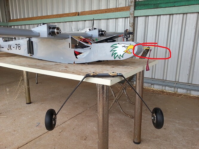

We’re you using the airspeed sensor?
its in the nose of auto land
took another plane out today wind was from 9 to 15 KT tried 3 time auto land it goes to stall
the glide slope was spot on to the last 10m from land point 3 meters high its cutting the throttle to idle then stalls and falls
is there way to switch to gps speed 3 meters off the deck

1 in take_off or auto mode plane veers off the runway
2 speed between waypoint all over the place and to slow no matter i set it to
3 stall and drop on auto landings

Check your airspeed sensor is behaving
can you recommend one ?
