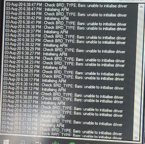

Check BRD_TYPE: Baro: unable to initialise driver
Hi
I have this Purple Cube, and today the Cubo wont start, so I have connected to MP and I got this error
I have try to put other firmwares, rover, plan, etc, but the same.
I have change the BRD_type to auto and to 6, but the same result.
After “boot” the Cube still with a led on
Any idea? Thanks
