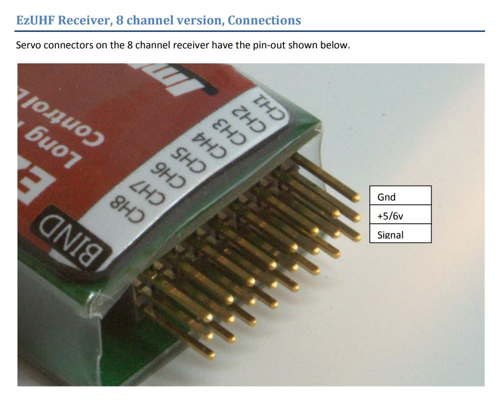

Everyone, I am considering getting into the Cube system but I do not understand how the RC receiver connects to the cube carrier board.
There are 5 outputs coming from the EZUHF RC receiver but on the cube system graphic (attached) I see only 1 small RC input. Thank you for your help.

Thank you @Alvin . I am using the EZUHF receiver which is comparable to the Dragon link. In the attached photo would I just use Channel 1 over to the cube carrier, and if so, is there a cable specifically for that and where would I locate it at a retailer?
From what I have learned from google, looks like you could configure it to output PPM signal from 1 pin?
I’m not very familiar with this receiver so I’m not sure.
