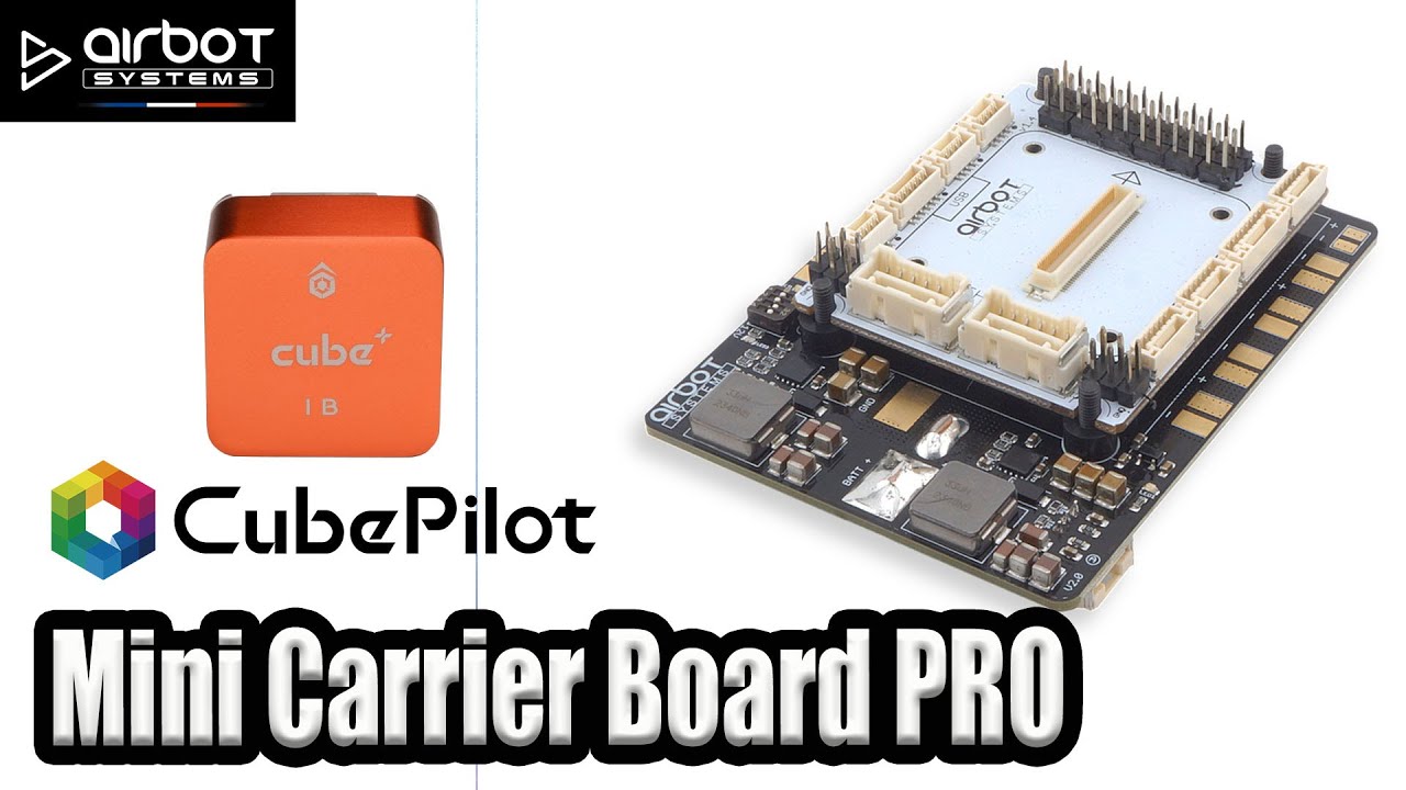

Oh and I see you are into FPV you will probably be interested in the coming soon Cube Racer.Based on the Node. I have no idea when that soon is.

That board is just an esc board it appears right? you still need connectors to power the cube. So weird.
