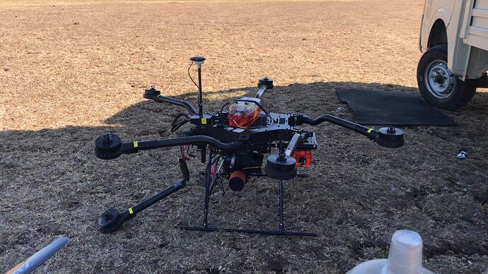

CUBE BLACK crashed AC 3.6.7 firmware( hexacopter)
running arducopter 3.6.7 chibios with latest cube black had crashed today during the loiter mode .

No video, we try to recover it in stablize from loiter mode but couldn’t have control
As seen from the log IMU failure is the cause. Could you tell more about the build? Have you disabled IMU? What is the powering source?

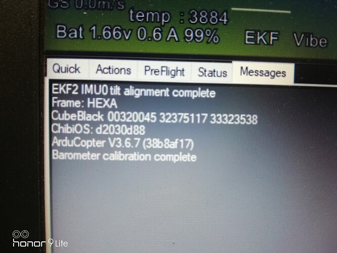

I checked 6cubes there is no zero value in INS_ACC_ID for all 3 values expect crashed one. Uploading: IMG_20190416_232314.jpg… Uploading: IMG_20190416_232221.jpg…
There is only one IMU value available and EKF_IMU Mask value is 1.
Other 2 IMU value is zero.
Pictures didnt get uploaded. keep them in a new line without additional text.
Can you please send the cube black serial number found in the messages tab? And the serial number on the base of the cube?
(Of the one with only one IMU)
