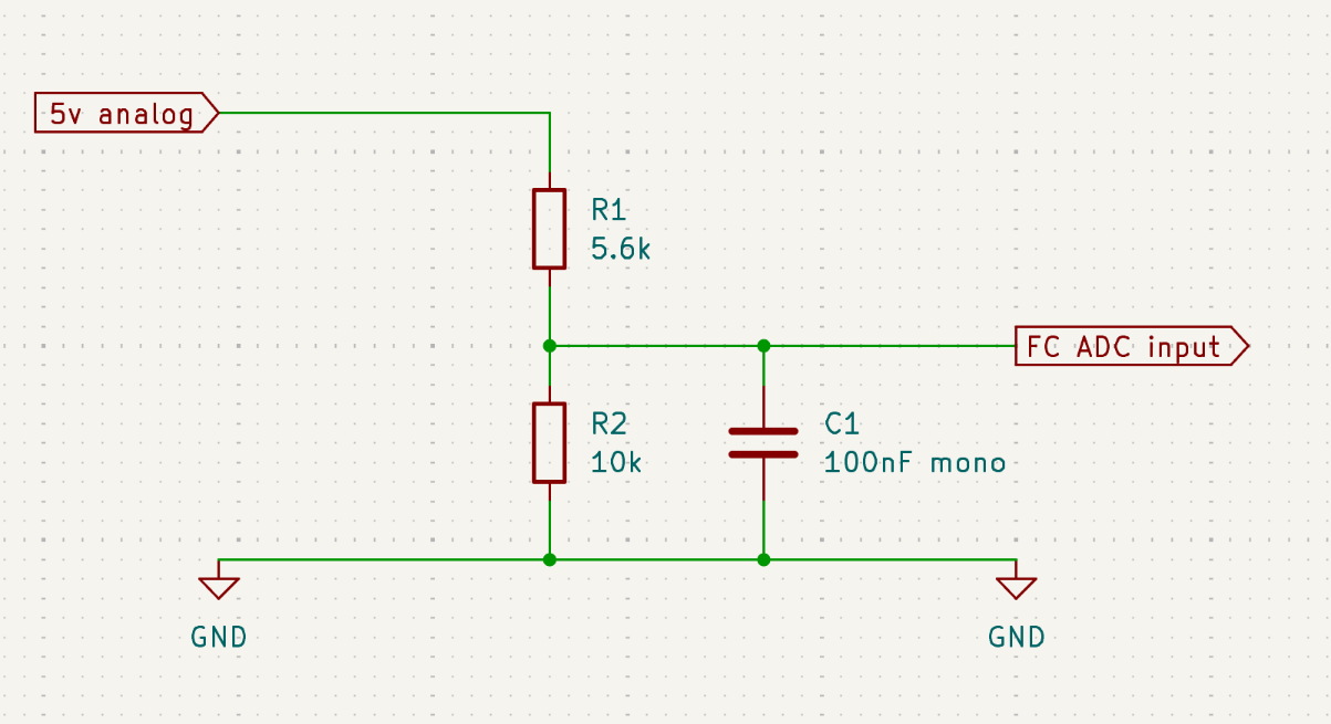

You would need a voltage divider like 5.6k and 10k
