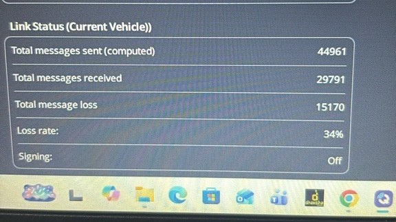

i have facing issue on the Cube Orange+ that packet loss was observed in Mission planner as well as QGCS On USB connection.

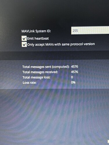

I disabled the Serial5_protocol = -1 which distortion of ADSB data and i disabled all parameter related to ADSB includes type as well., after set this parameter then i reconnected USB and not seen any packet loss. below screen shot is for showing that.
Next step, same Cube connected through data link ( SIYI , IP data link ) in both android and Windows application of QGCS with Data link it continuous data/packet loss was observed. Refer the QGCS Screen shot of data loss.

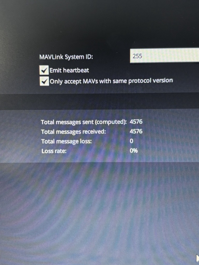

Same Setup of procedure was followed on the CUAV X7 FC through USB and same mentioned or used data link. Both connection there was no issue of packet loss at all.
I also check the LDPC fail counter on the data link found no loss of packets on the data link . clearly evidence that no issue with data link also.
Due to this loss of messages/Packets GCS can not able to read complete parameter and pop up error window.
Why what is the reason that cube Fc facing packet loss issue.
Because you have noise on your communications interface. The Cube and Mission Planner are working correctly and telling you that there are problems with your setup.
Please read my statement clearly. With same set of data link and communication wire CUAV X7+ flight controller worked correctly. On the CUAV X7+ FC zero percent loss rate on data link as well.
