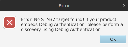

Our cube orange plus recently stopped working with a constant red light and a pulsing green light. After reading other similar posts, we tried to connect with an st-link v2 to the cube. Unfortunately, our board doesn’t expose the FMU_SWDIO and the FMU_SWCLK pins so we made a really simple pcb that exposes those 2 pins along with the two gnd pins to check that the numbering of the pins is correct (it is) and pin 26 (IO_VDD_3V3) to power the board. We connected gnd vdd and the two FMU pins to the st-linkv2 and the cube powers on but again with a constant red light and a pulsing green light. ST Programmer sees the st-link but when we try to connect we get an error: No STM32 target found!

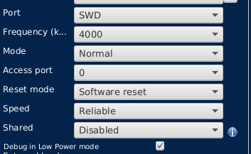

Are different settings required here? We tried different Modes and reset modes but maybe there is a very specific combination needed?
