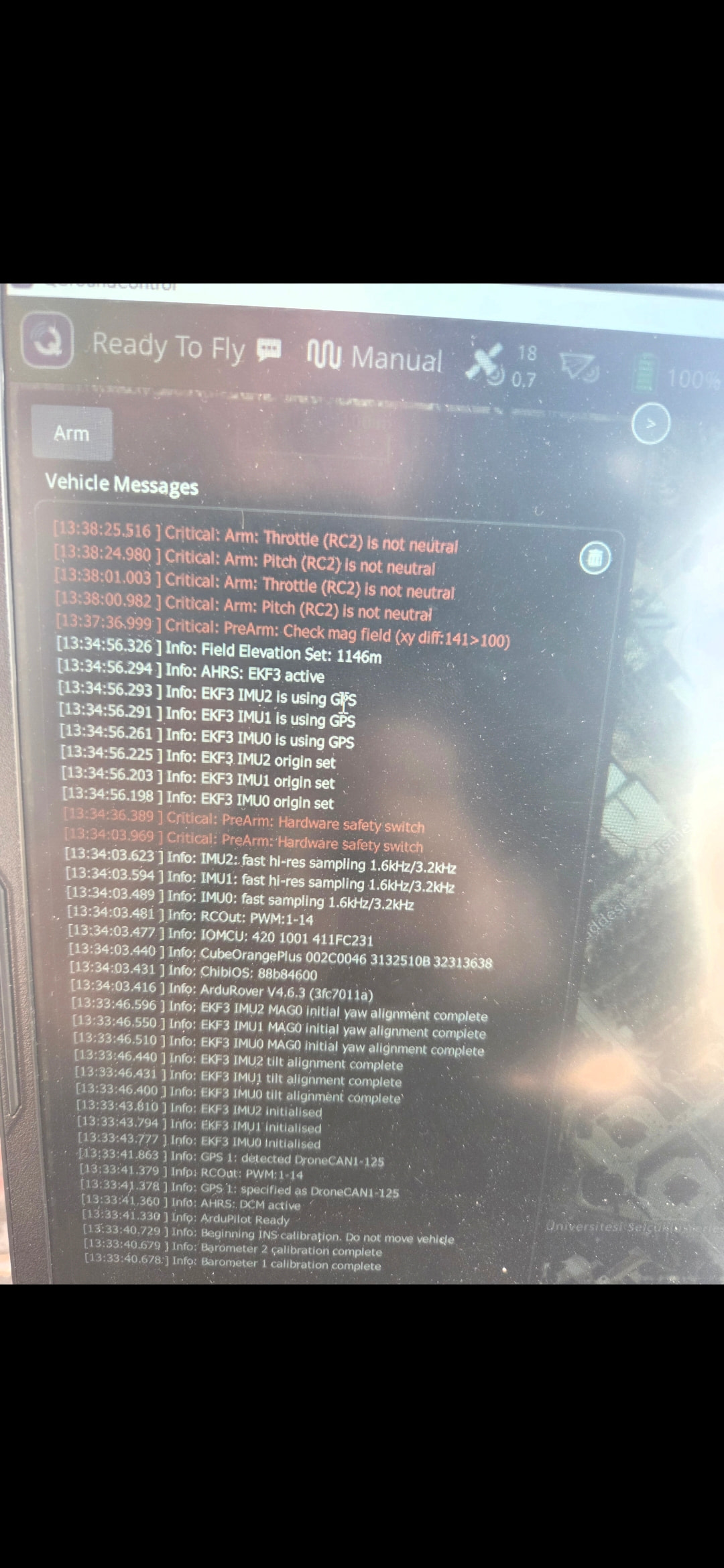

Thanks to your help, I have resolved the GPS and Compass issues. The system is now showing “Ready to Fly” and I can ARM the vehicle successfully.
​However, the original issue I described in my first post is still persisting:
Even though the vehicle ARMs now, the motors still beep rapidly as soon as I connect them. It seems like the Cube is sending a “Full Throttle” signal immediately upon connection.
​I still get absolutely no response from the RC Transmitter sticks. Moving the throttle or steering stick does not stop the beeping or spin the motors.
​Do you have any advice on which parameters I should check to fix this output signal issue?
