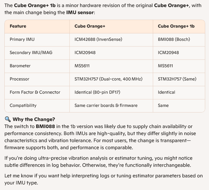

I looked up the difference this afternoon - it appears that the difference is the IMU.
