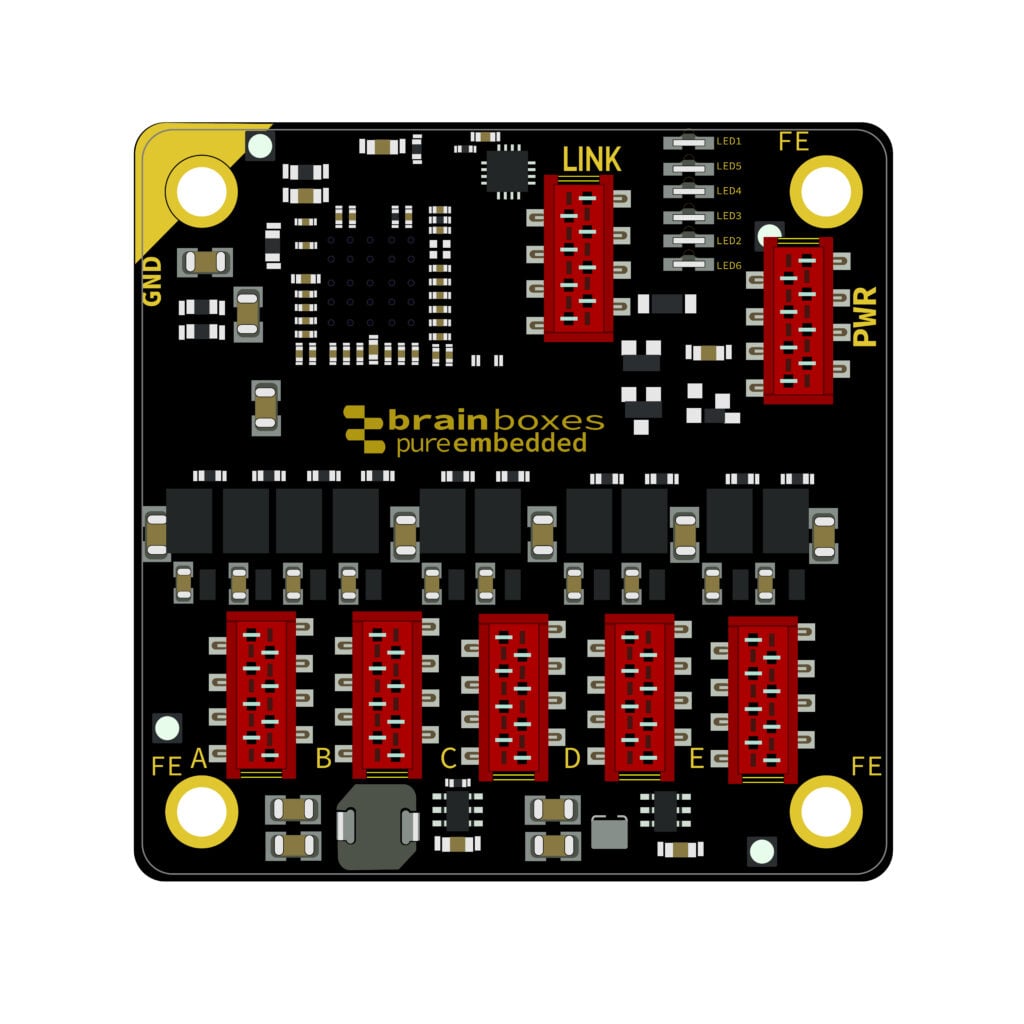

I would also like to test it with this cheaper brain boxes gigabit switch, which uses TE Micro-MaTch connectors. No idea why they used ribbon cable connectors for gigabit ethernet, but alrighty.
