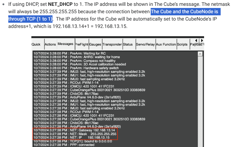

I have currently a Cubenode-ETH setup on an Orange+ flight controller and it is connected over a IP mesh radio. It is working ok for the most part but every so often I can’t connect to the aircraft via Mission Planner. I can however ping the IP address of the Cube. I know that if it connects via TCP and drops the connection that you can’t re-establish it without rebooting the flight controller (please let me know if that statement is incorrect) Does anyone know if we can connect via UDP through the Cubenode-ETH noting the image above that states a 1 to 1 TCP connection to the Cube.

I also had the problem with Mission Planner not being able to re-establish a TCP-connection. I found out that this problem does not occur when using QGC. I am able to connect and disconnect several times. But when using MP I can only connect and disconnect once.
