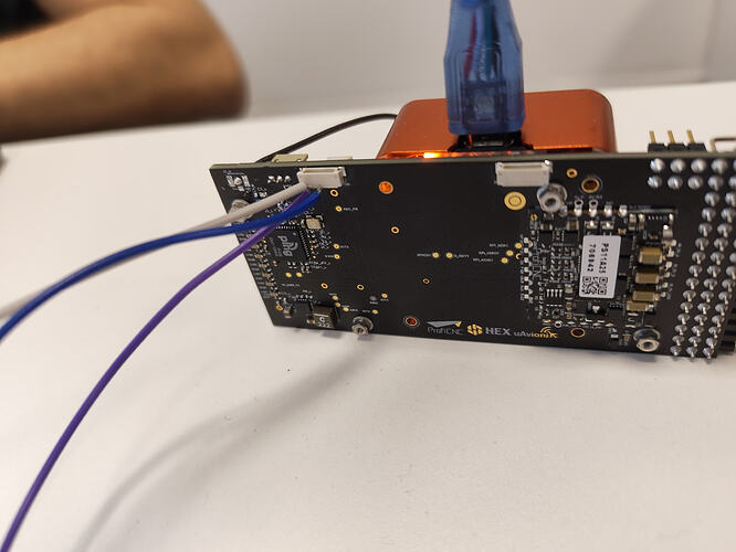

Here starts my journey into trying to unbrick the cube. I’ve tried soldering ST-Link cables to FMU connector (view pic below).
I’ve used STM32CubeProgrammer and STM32 ST-LINK Utility, but i can’t communicate nor see the Cube.

is it responding on jtag at all?
I just don’t understand if i’m using the correct jtag port and/or if i’m connecting the the right pins to the st link, but no, the cube is not responding through the jtag using the pic setup.
