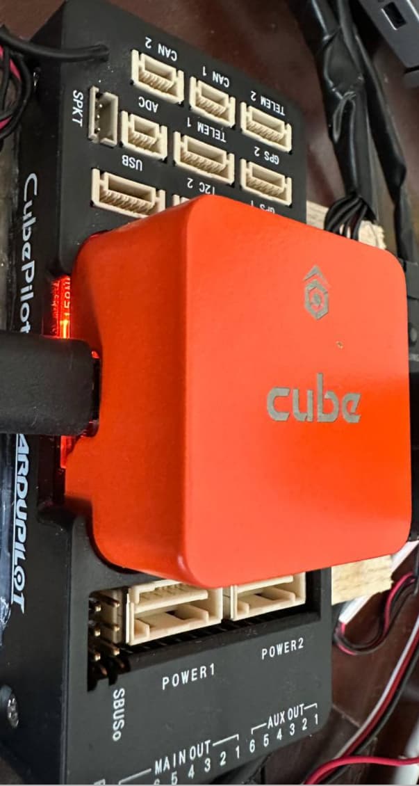

CubePilot Orange plus stopped working
Cube Orange Plus connected to the external battery or through USB it sends just one long beep and does not load.
In the System it is recognized as COM6 and COM7 (MavLink) but it is impossible to connect to the MissionPlaner, QGC, MavProxy, STM32CubeProgrammer also can not connect.
What else is possible to do and how is it possible to Update the BootLoader?
also i have tried the next solution:
1.Open MissionPlanner
2.Do not connect through the port
3. Go to the Setup → Install firmware
4. Chose the Plane - for question want to upload - Yes
5. Check the CubeOrange from the box (There are two options for CubeOrange - i have tried both)
6. Then press Update Firmware
7. It is dowloading from Internet and reading Hex file
8. it is showing the message to unplug, then press ok and then connect board again
9. Then program make Erase then Program, then show Update Done
10. If i unplug the board and try it again the same One Long Beep and can not connect to the MissionPlaner
There is no any devices connected,
I removed the sd card and put the clean new one
Anything is helping - after all one Long Beep and mo possibility to connect to Mission Planer and Other software
