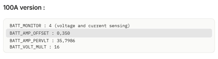

Hello, I am using the Mini Carrier Board PRO v2 for a boat, but when measuring current from Mission Planner, the measurement gets stuck at one value and does not want to go up to its actual measurement. For example, when I accelerate my motor, I read up to 9.7A in Mission Planner, but I am at 25A when measuring with other equipment. I am using the parameters indicated by the manufacturer. Does anyone have any idea what might be happening?
