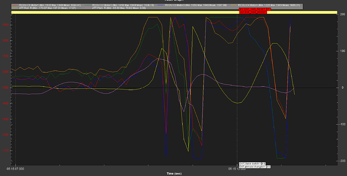

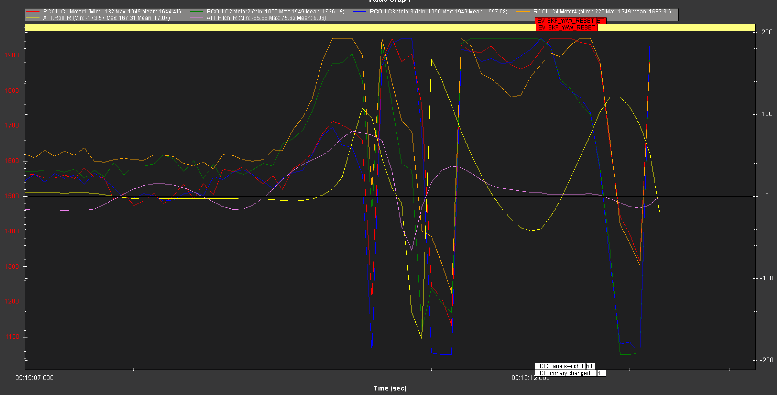

I would say the cause is a physical problem with Motor4/Prop4. Look for anything like a broken prop or mounting issue, even a twisted/loose motor mount or broken arm. Since both motor4 and 2 are effected, it could even be a serious weight shift to the rear, such as the batteries coming detached - but you probably would have seen this, and they may have disconnected too (which was not evident)
I’m fairly certain this is not an ESC desync though, as that usually takes some time to recover and is more evident - the suspect motor/ESC would be commanded to maximum for a longer period of time.
You can see in the graph that pitch and roll go bad slightly after Motor4 is commanded to maximum (a sure sign of no thrust) and also motor2 is commanded near maximum possibly indicating a problem with both rear motors or props.
The EKF lane changes only come after the copter is tumbling down and the flight controller is trying anything it can.
