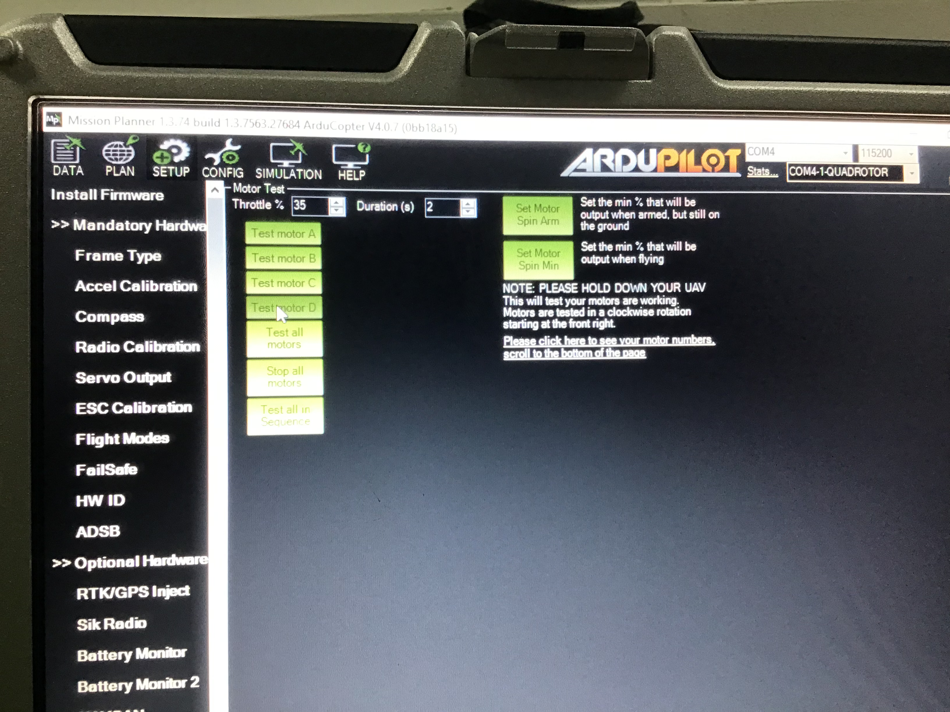

Hi there guys, well I have an issue with my esc calibration, I am setting up a quad x drone and I have 3 esc that has the same calibration but one of them is out of sync, I’ll elaborate on this
When I perform the motor test on MP, 3 of them start at 5% and the last one only start when I dial in 35 % in “throttle percentage”. So far I have done the esc calibration multiple times but the motors still are out of sync as depict in the following pictures.
Can you try that motor-ESC set with a PWM tester?
Also, what happen if you swap the faulty esc to another PWM out port? Can you verify which part is faulty?
