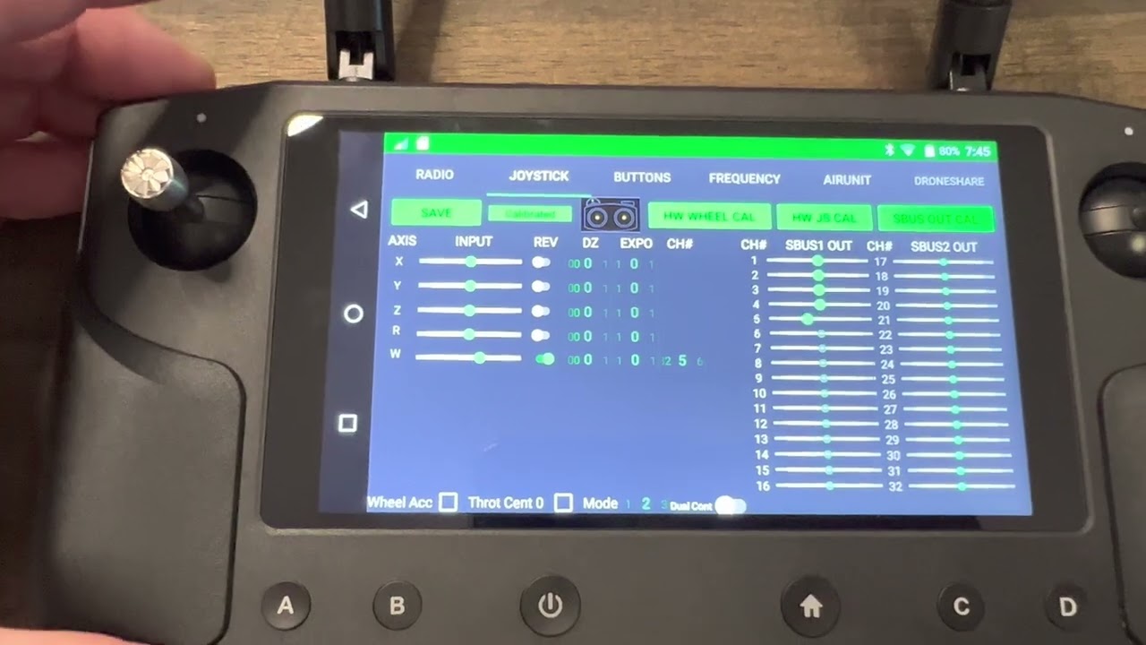

I opened a brand new Herelink and applied the most recent update.
I’ve calibrated the wheel several times but it seems to just sit to the left or right of center most of the time after returning to center. If I let the wheel ‘snap’ back to center, it will most of the time center correctly. At the end of the linked video below, you’ll see the wheel just not respond at all for a moment.
Anyone else having this issue? I did a search but couldn’t find anything specific to this. Below is the current build information and a link to a video.
Video: https://youtu.be/XX8-OqY6Ddw
Here’s a second issue with the scroll wheel. When set to accumulator mode and the scroll wheel is moved, the slider will just run to the end. Please see video.
Is this a product defect? I’m on controller #2 now. I can’t be the only one to experience this. Is there a fix?
