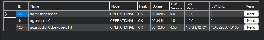

I am also experiencing the same behavior. My setup: CubePilot+, MissionManager (latest on Windows), Using Firmware V4.6.0 Official, Updated CubeNode ETH to 1.9.8. I also see a discrepancy between the docs here and my setup since the DroneCan screen shows org.ardupilot.CubeNode-ETH instead of org.ardupilot.CubePilot-PPPGW
