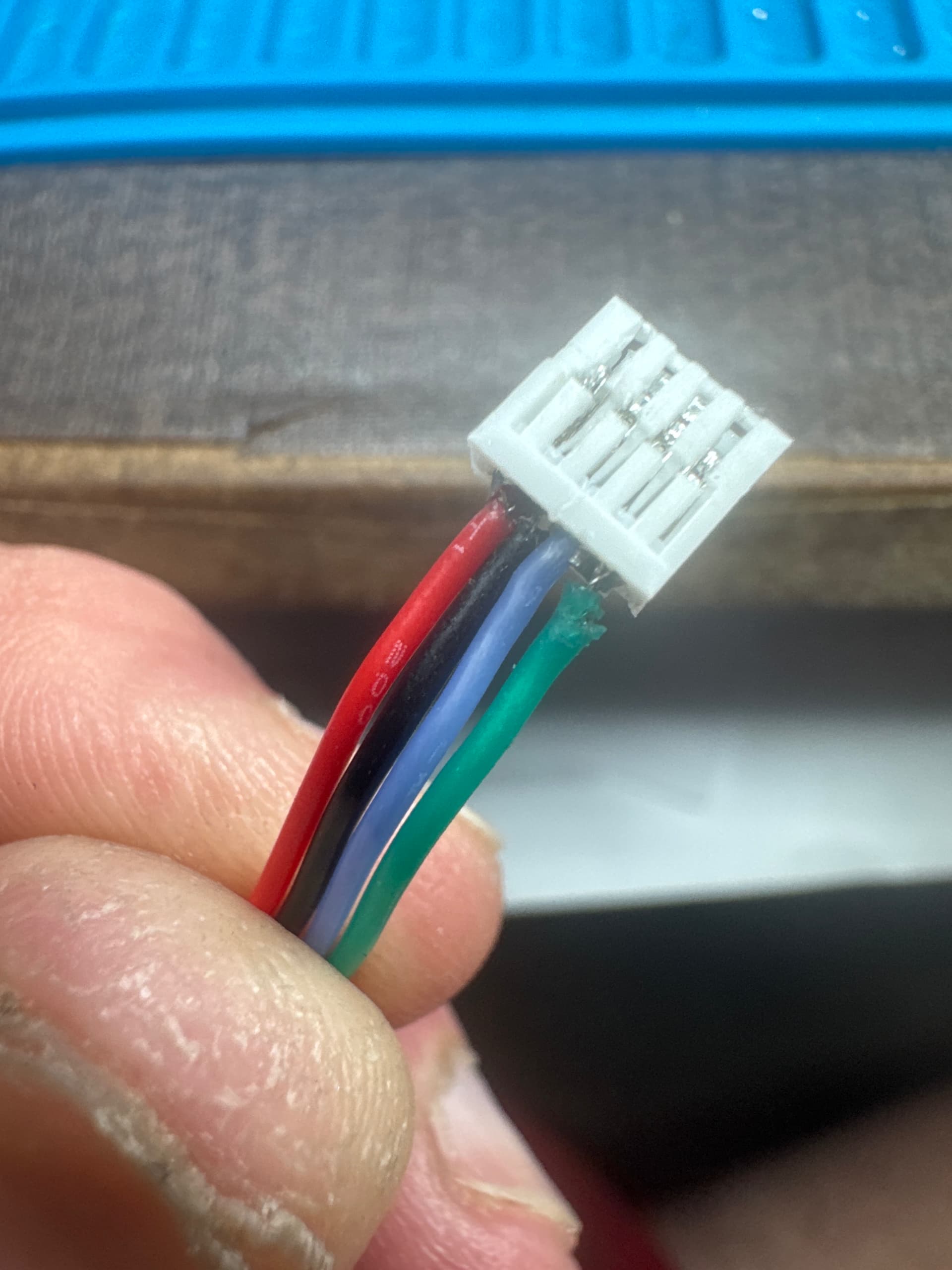

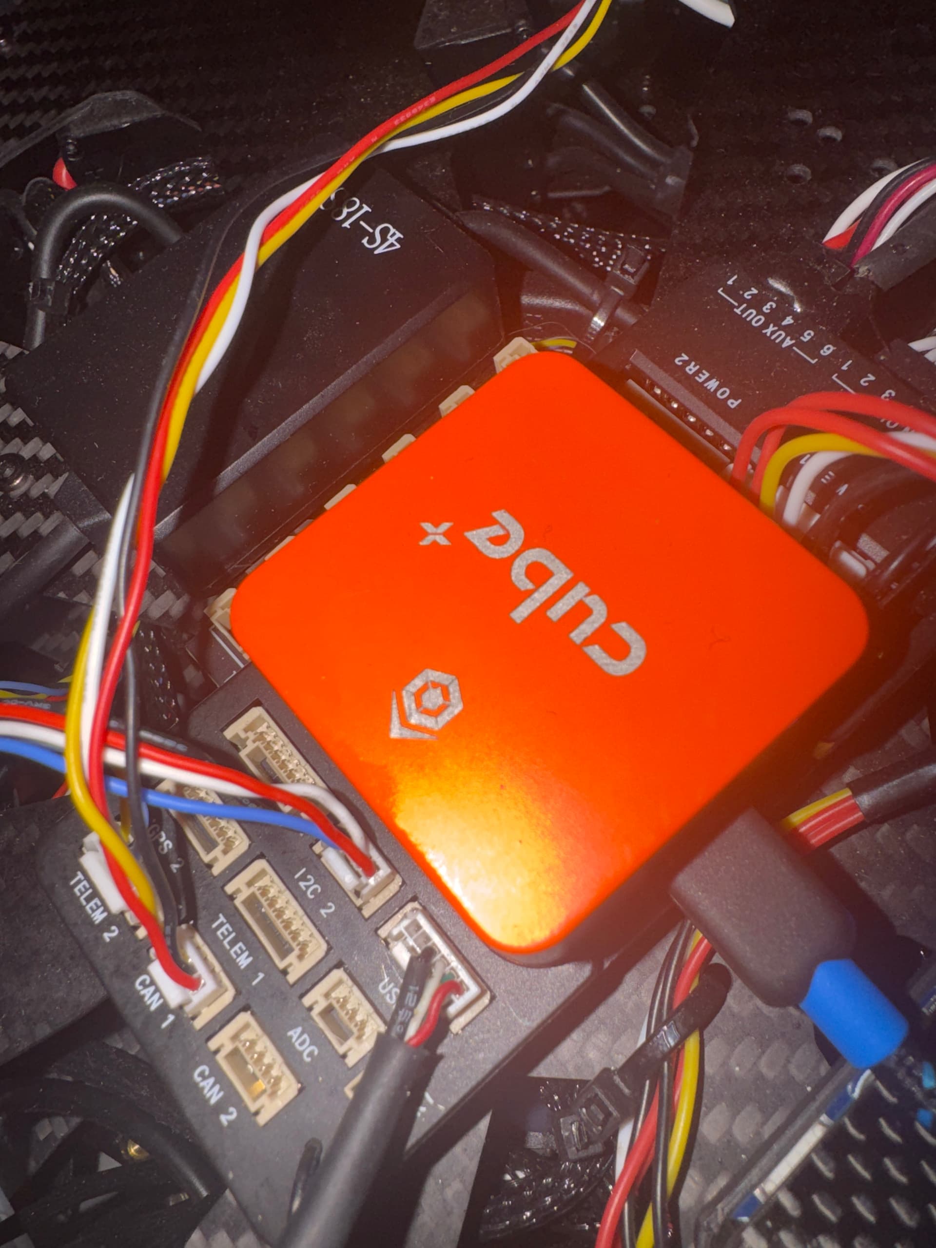

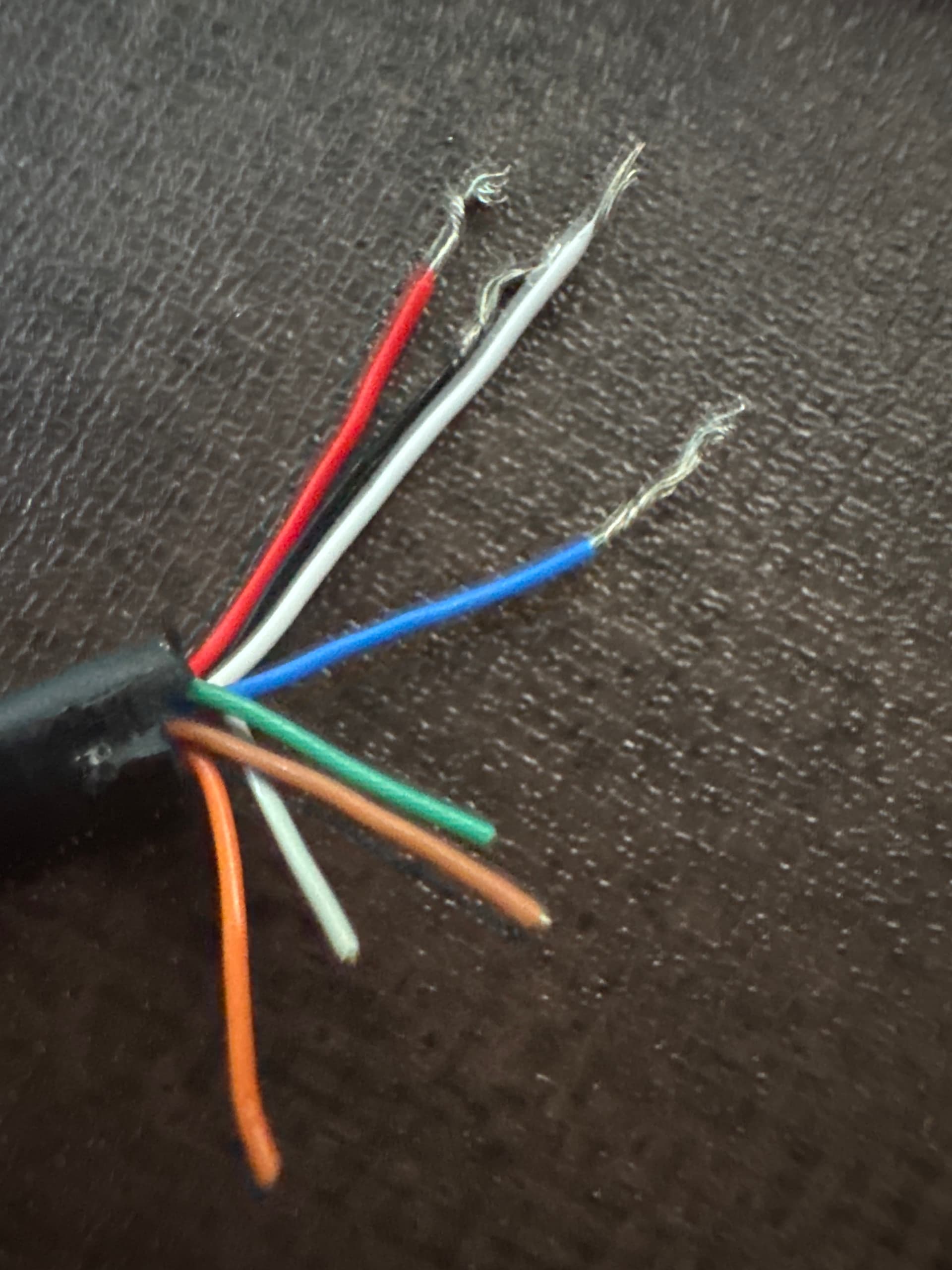

I was sent a heavy lift drone recently with a here 4 gps. The cable was broken. 8 pins are coming out of the here 4. 4 pins go into jst connector into I assume the can 1.

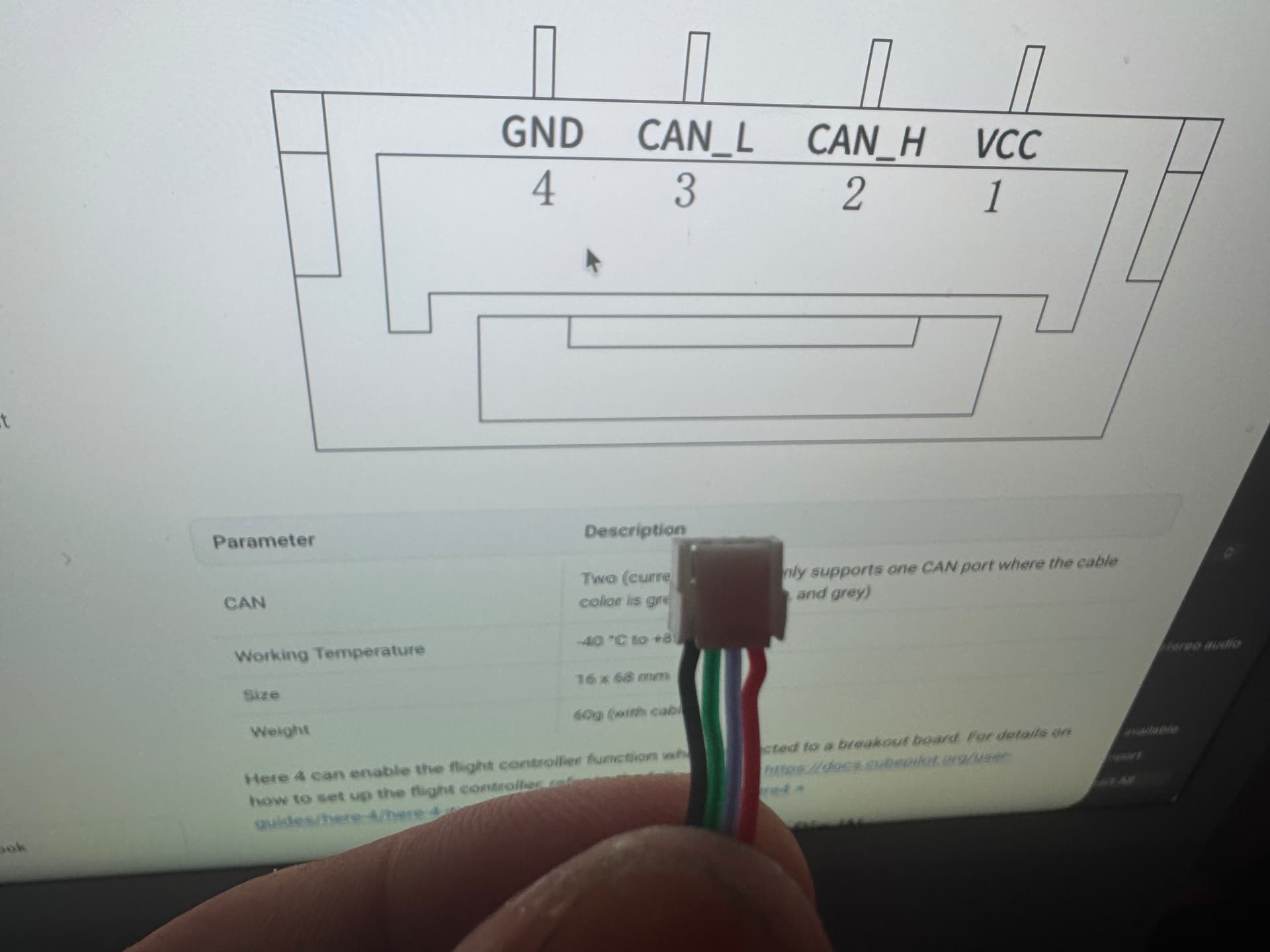

Chat gpt says pin out on jst with the tab clip facing up. It says do it like this I got rainbow light pattern on gps, chat says flop the l and H can pins. I got solid red lights. I went to cube site their pin out for can 1 was totally different. I tried their pin out and I got no lights.
I assume when I had they’ve rainbow light show I was close.
1st I need to verify what color wires out of the 8 will be used I read red black blue green and pink them from left to right tab clip up on connector.

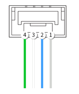

The original CAN1 wire colours are:
Grey Vcc
Blue CAN_H
White CAN_L
Green GND
The CAN2 port (red, orange, brown, black) should be avoided at this stage.

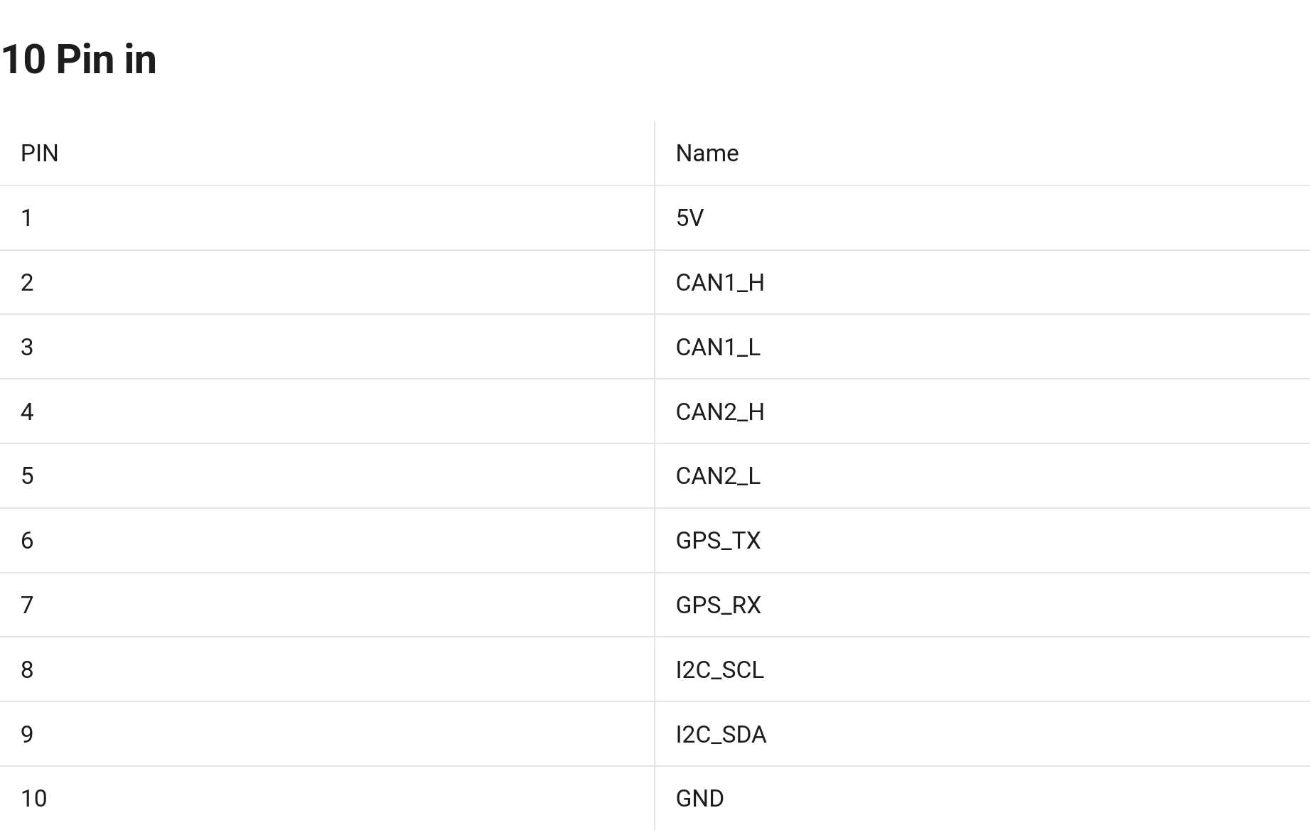

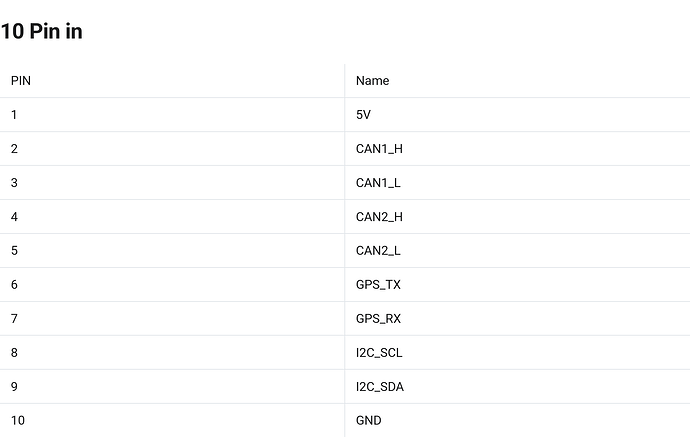

And the Here4 internal connector is:
