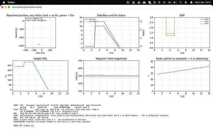

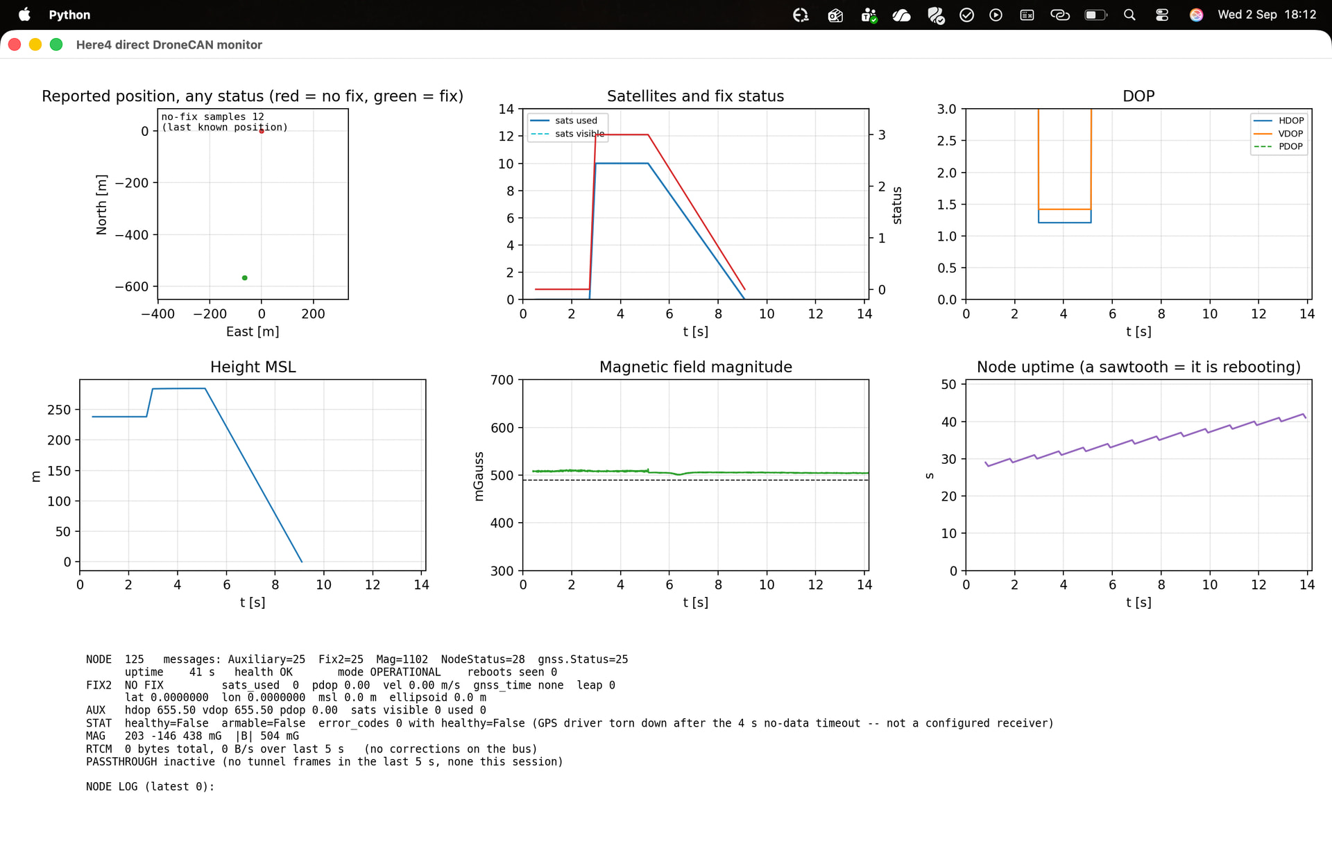

Here4 gets a 3D Fix in u-center, but Mission Planner does not receive GPS data
I am experiencing an issue with a Here4 GNSS connected to a Pixhawk 6C Mini via DroneCAN. The Here4 itself appears to be able to obtain a GNSS position, but Mission Planner does not recognize any valid GPS data.
Hardware / Software
  • Flight Controller: Pixhawk 6C Mini
  • Flight Controller Firmware: ArduCopter 4.7.0
  • GNSS: CubePilot Here4
  • Here4 Hardware Version: 4.19
  • Here4 Software Version: 1.15.6C3DC6B5
  • Connection: DroneCAN
DroneCAN Status
The Here4 is detected correctly in the DroneCAN page of Mission Planner.
  • Node ID: 125
  • Health: OK
  • SW Version: 1.15.6C3DC6B5
  • HW Version: 4.19
Therefore, it appears that the Here4 node itself is communicating normally on the DroneCAN network.
GNSS Status

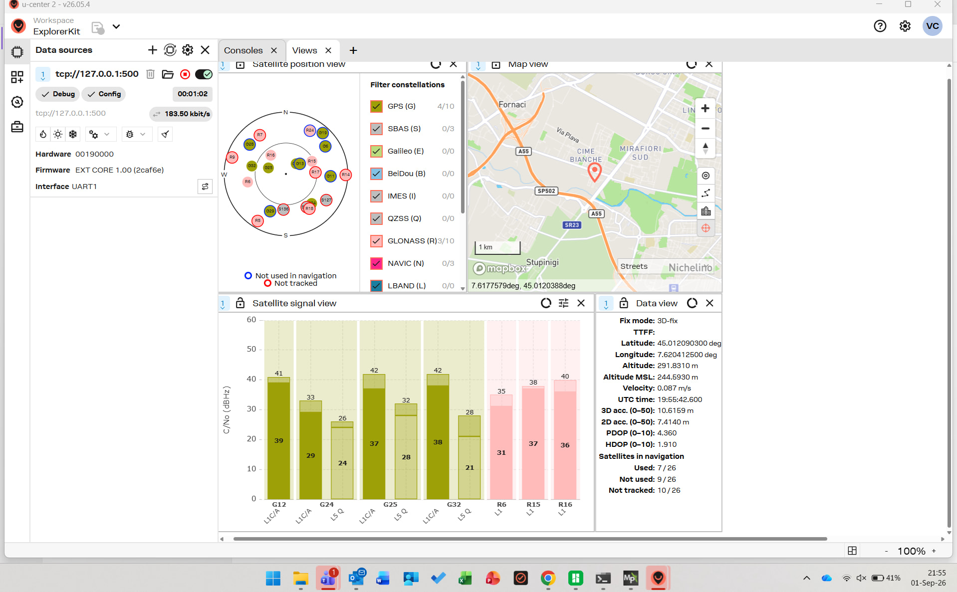

In u-center, I can obtain a 3D Fix and position information.
However, ArduCopter does not recognize any valid GPS data.
In Mission Planner, all GPS-related values are 0, and no GPS Fix is obtained.
I would appreciate any advice on what I should check next.
