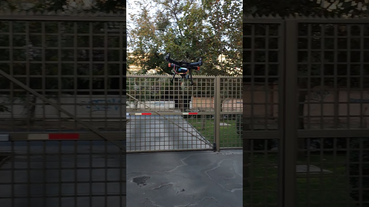

Here is a video, where I just move FW and BW, Im not braking, I only release the stick, then the drone brakes, and try to come back

Have you followed these instructions?
https://ardupilot.org/copter/docs/common-hereflow.html
And what mode are you in?
Yes!
Loiter flight mode.

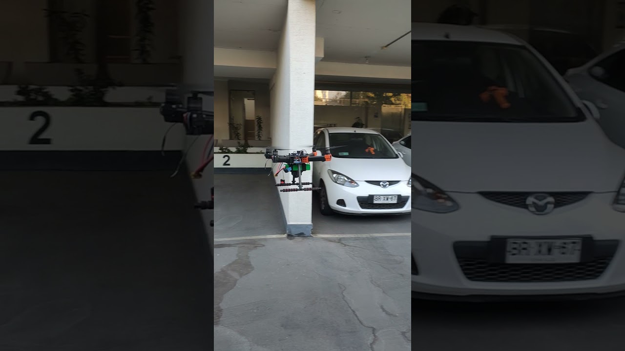

I made it work without GPS, works better, but still having the “bouncing” break. The drone stays very good, then Im going forward, and when I release the pitch, the drone stop and come back at least 1 meter. The same happened with the roll
here is a video

Can you try again with less aggressive altitude change? I am thinking if the tilted attitude during the brake may have confused the flow sensor.
As you see in the test video, the angle change was very small.

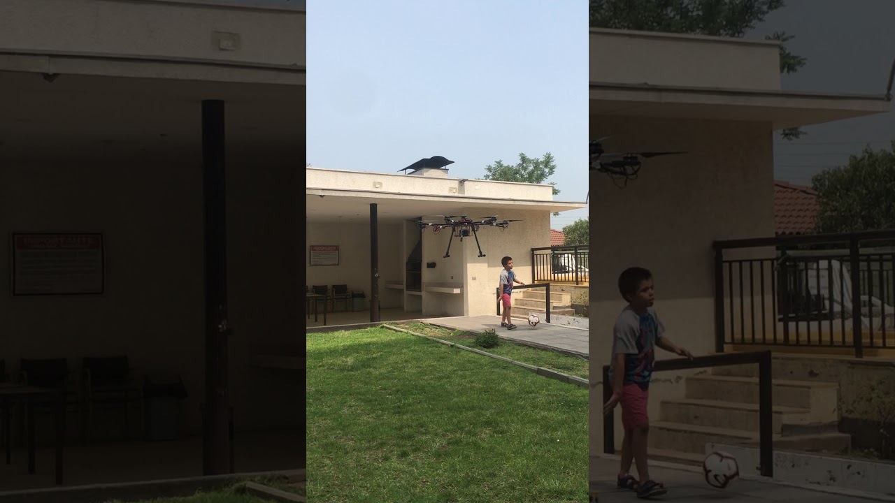

Thanks. I will try. I was working with the FLOW_SCALE, and I got an improvement, here is the video
I saw the video you have sent, and yes at the begining the movement were very soft, but at the final, they did a similar movement.
The Flow_ has a lot of parameters, but I dont know how to tune them. What can I change beside the _scale paremeter? thanks
None of the parameters in CAN should be changed.
Please use an SF11 or similar high performance lidar.
Other than this, following the Ardupilot guide is all that’s needed.
