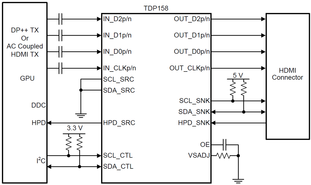

so to take an outside view of this issue
have a read of
https://www.audioauthority.com/page/hdmi
you will notice that 90% of the data travels from the source (camera) to the Destination (herelink),
the only 2 ways comms is DDC and CEC. on herelink CEC is not used, and DDC is used to detect the resolution etc, ie very minor traffic.

and how a hdmi repeater works
you will notice that all the video data is one way,
the DDC is 2 way, and used to setup the image format specs.
