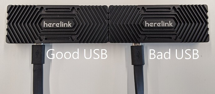

Is the Herelink showing up in the device manager?
You may also check if the usb connector is good or not. Bad usb port won’t let you fully plug to the end.
