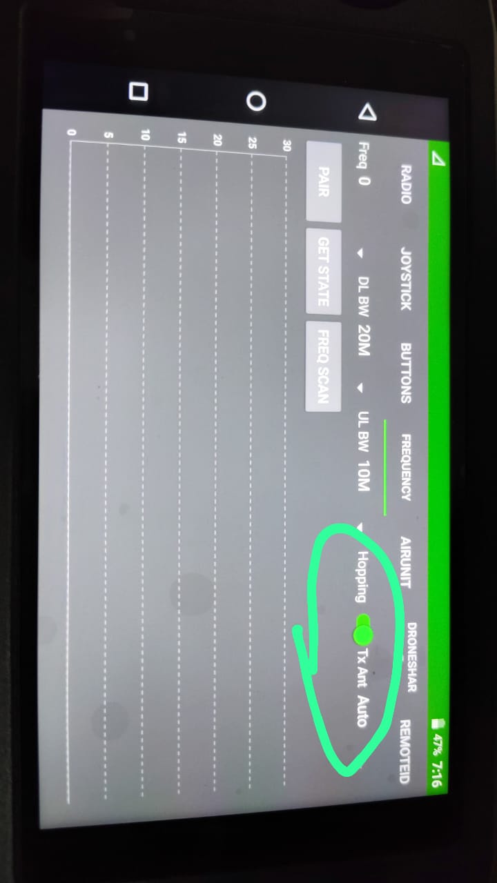

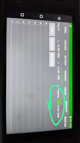

There is “TX Ant” drop down in the Herelink configurator. What it function for the v1.1 units?
Is it really Ant 2 RX only for the v1.1 airunit or it can be switched to TX as well somehow?

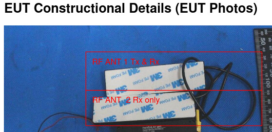

Here is HX-06210 (Herelink Air Unit v1.1) FCC Test Report
See Ant 2 remark at page 6:
So, is Ant 2 indeed receive only, or it depends on unit firmware version?
Appendix - Internal Photos for GZCR2204000403AT
Test Model No.: HX4-06210
Photo at page 2:
So, does firmware matters, or no matter what - Ant 2 is receive only and thus there is no reason to attach it to RF booster?
