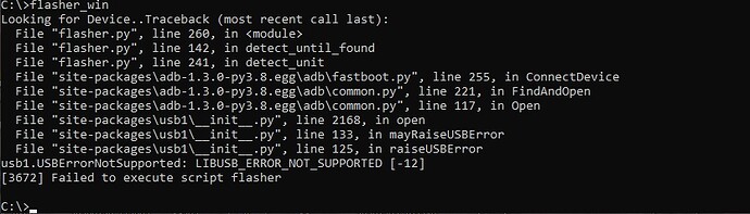

I am having a similar issue. I have checked the radio is on the right firmware and it is on the Stable Version. The air unit will not pair no matter how I have tried. I do not know if the air unit is on the right firmware and I do not know how to check. Every time I try to flash the air unit it goes through the screen so fast I can not see the details on how the flash went. One more thing I have to note as well is the settings App on the herelink TX keeps crashing when I try to use the D2D setting or Bluetooth tethering. I hope someone has some insight as to what to do. Thanks in advance
Here is a screen shot of what I am getting when running the flash to the air unit
After ADB drivers were updated it started to work right away. I guess I thought Windows 10 would have all those drivers straight out of the box but I was incorrect. I did notice on my computer that I was only able to see the issue in my device manager when the radio was in fastboot mode and I had the device manager open to see the exclamation point next to it. Anyway thanks to Phil as I looked into it further and he was right it was definitely the ADB drivers.

When following the usb driver instructions here, my computer told me the driver is up to date, so i had to force the install with another method. I just want to document it here so others don’t have to struggle. Download the google usb driver zip file, extract it. Right click on the android_winusb file and press install. THe install takes a split second. Then you should be able to run the flasher.
