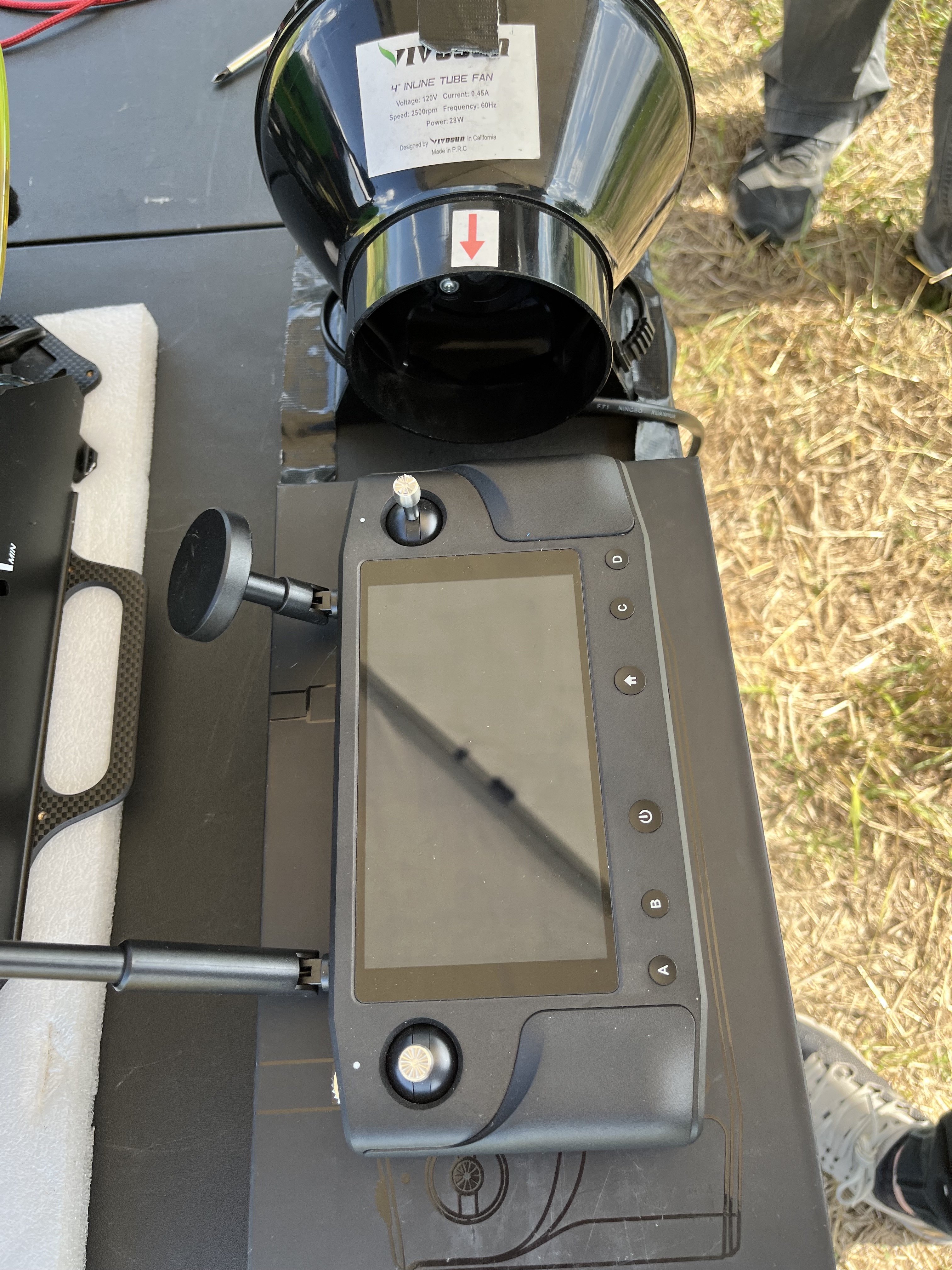

This is my summer setup moving forward. :frowning:
