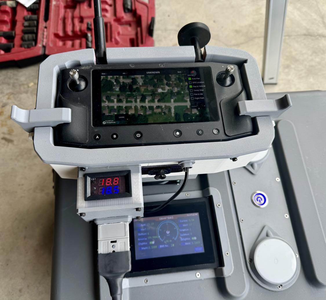

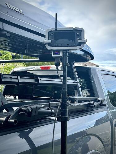

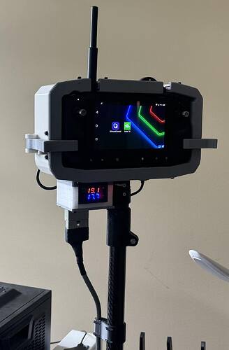

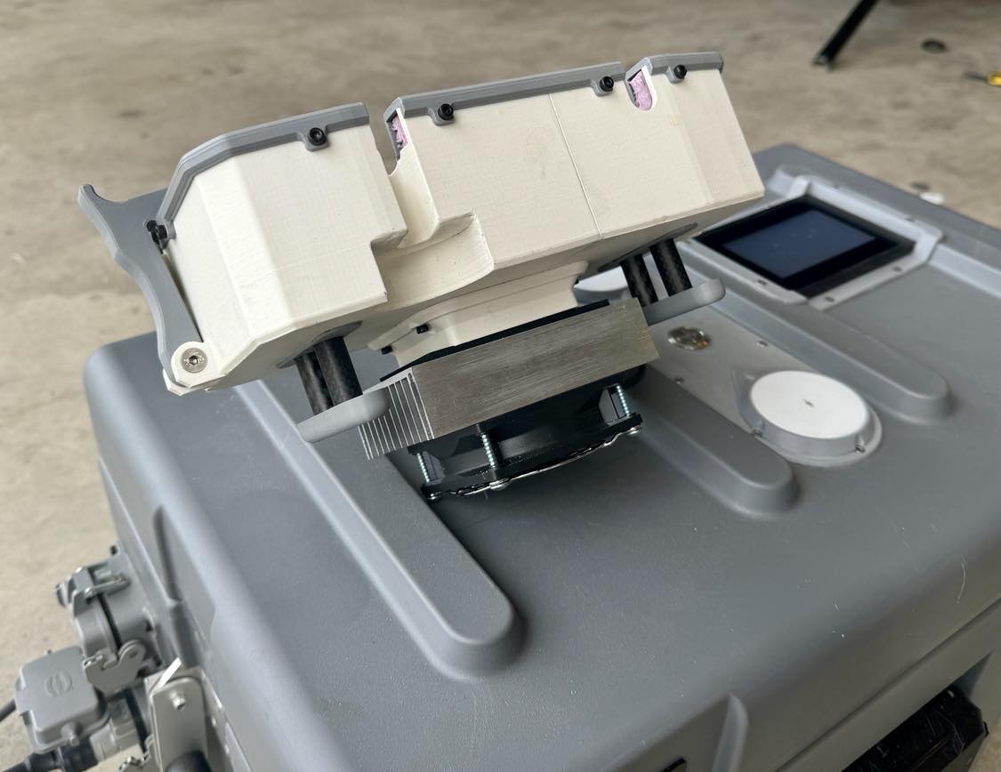

Getting hotter out so I thought I’d finally make a thermocouples cooler for my Herelink units. My problem is temperatures above 27 or 28c will cause the unit to shut down. Part of the problem is the Herelink is up a pole acting as a relay to give us better range doing bathymetry. I use it for flying as well… I prefer the air-conditioned
comfort of my truck lol! Add the constant exposure to the sun and always charging, it heats up fast. I haven’t taken it to work yet, but it keeps the set temperature and keeps the radio charged.
