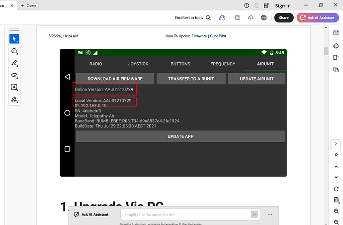

Ok…what is the GCS software on your Herelink
When i check for updates current version is RU01240301
But the warning says ensure airunit is up to date before updating GCS
ignore this

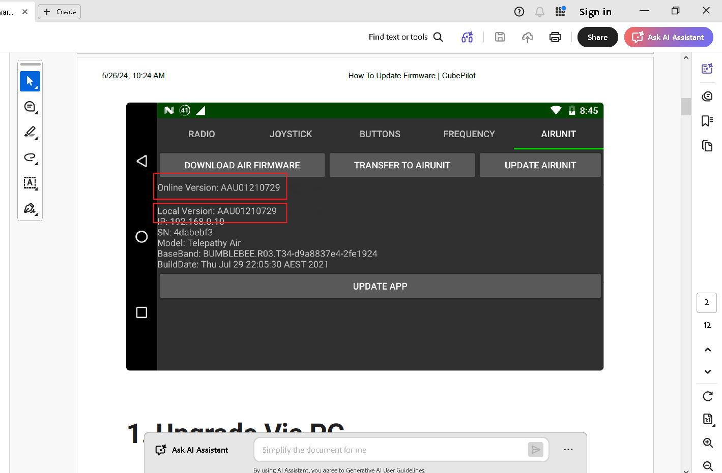

this is the version number of the Herelink GCS….what is the version number as per the attached
All i saw was an online version number
