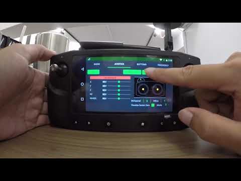

I’ve PASS the “HW WHEEL CAL”, but FAIL to finish “HW JS CAL”. By following the upper-right instruction steps during the joystick calibration, the R-X/R-Y/L-X/L-Y always showing 0.000, and can not complete the last step with “PASS”, the black circle just won’t move.

I’ve tried the way you suggested, the problem were still the same. HW JS CAL just wont pass and nothing happened during the calibration.
But, I’ve found that when changing to the BUTTOM page, “setting fail” message will pop out.
Any ideals? or the problem was caused by hardware malfunction?

What you show in the video at around 2m is good. Just continue with what the left box is telling you to do. The right screen is not updated (yet). If you continue doing, at some point it start updating and working. Quite confusing but its working
