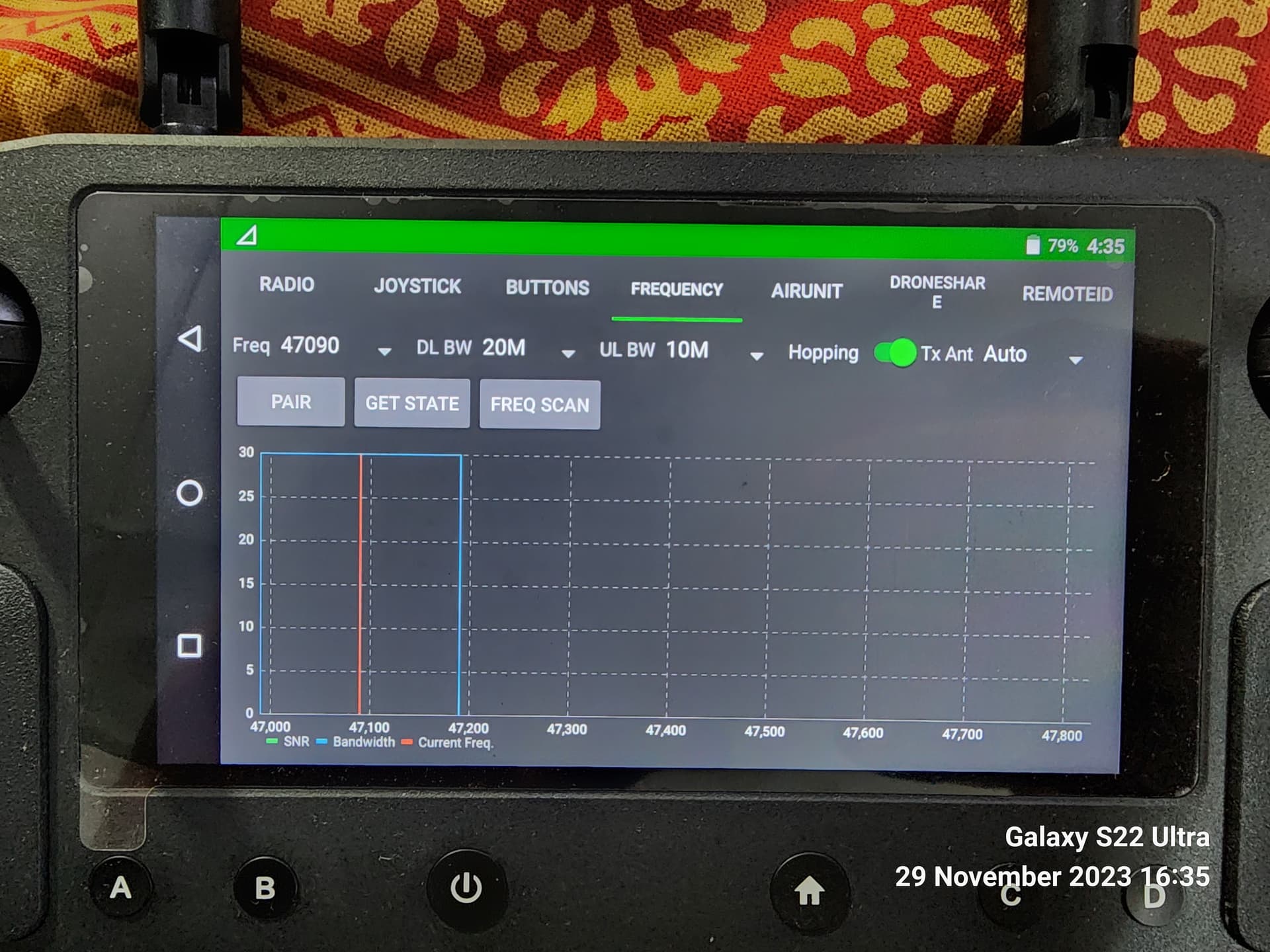

I’m facing an issue with my new herelink v1.1, that it keeps on randomly disconnecting.
Sometimes it disconnects within 15 seconds, and sometimes after 2-3 minutes, sometimes after 4-5 minutes.
Today while flying, it disconnected randomly and then kept on re-connecting and disconnecting every 5-10 seconds or so.
I tried to get a look at the air unit LEDs, and both were yellow, which confirms that the air unit had power.
Both the antennas are placed on the legs of the drone at around a 15-20 degree angle and the air unit also has fan installed, and mounted on carbon fibre frame for better heat dissipation. Both the air unit and GCS are running latest available firmware.
This disconnection isn’t related to telemetry or sbus cable being loose or something because, in the frequency spectrum page itself, the signal disappears as shown in the pictures attached.

I waited for a few minutes, and it disconnected .
The frequency spectrum page went blank as shown in the pictures I uploaded in the starting. And now, the same thing started again, that it reconnectes in 4-5 seconds, works fine for 1-2 minutes, disconnectes again, reconnectes, and so on.
