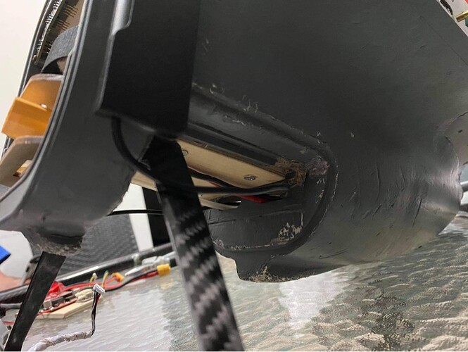

I place my antennas at this side of UAV. It’s near the carbon bipod but not in contact.
Alvin
5
You may try to swap the orientation of antenna
