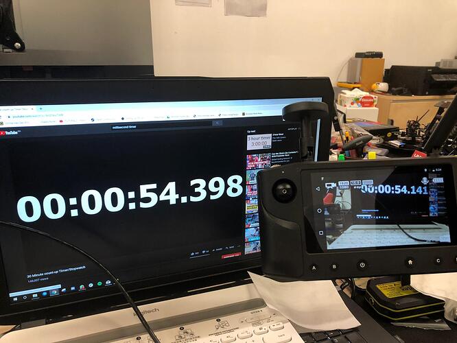

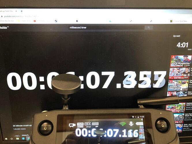

The test setup:
cameras settings: turn off all auto functions like auto-exposure, anti-shake, auto-focus, etc.
connect camera hdmi output to Herelink air unit’s hdmi input1
Herelink’s rtsp share turned off.
face camera to YouTube playing a millisecond counter and use a mobile phone to video the counter on the computer screen and Herelink screen at the same time.
