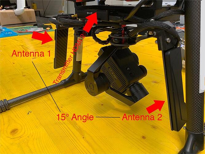

I have now connected my Flir camera to the hdmi port 2 and mounted the video transmitter at another position on the copter. I have also removed the antennas from the landing legs and I have them now mounted on a separate bracket with 15 degrees angle. now the picture is much better. Who is actually the investor of the herlink or which company? 3DXR or CubePilot?

Probably could get better antenna performance too if they weren’t mounted to CF brackets
