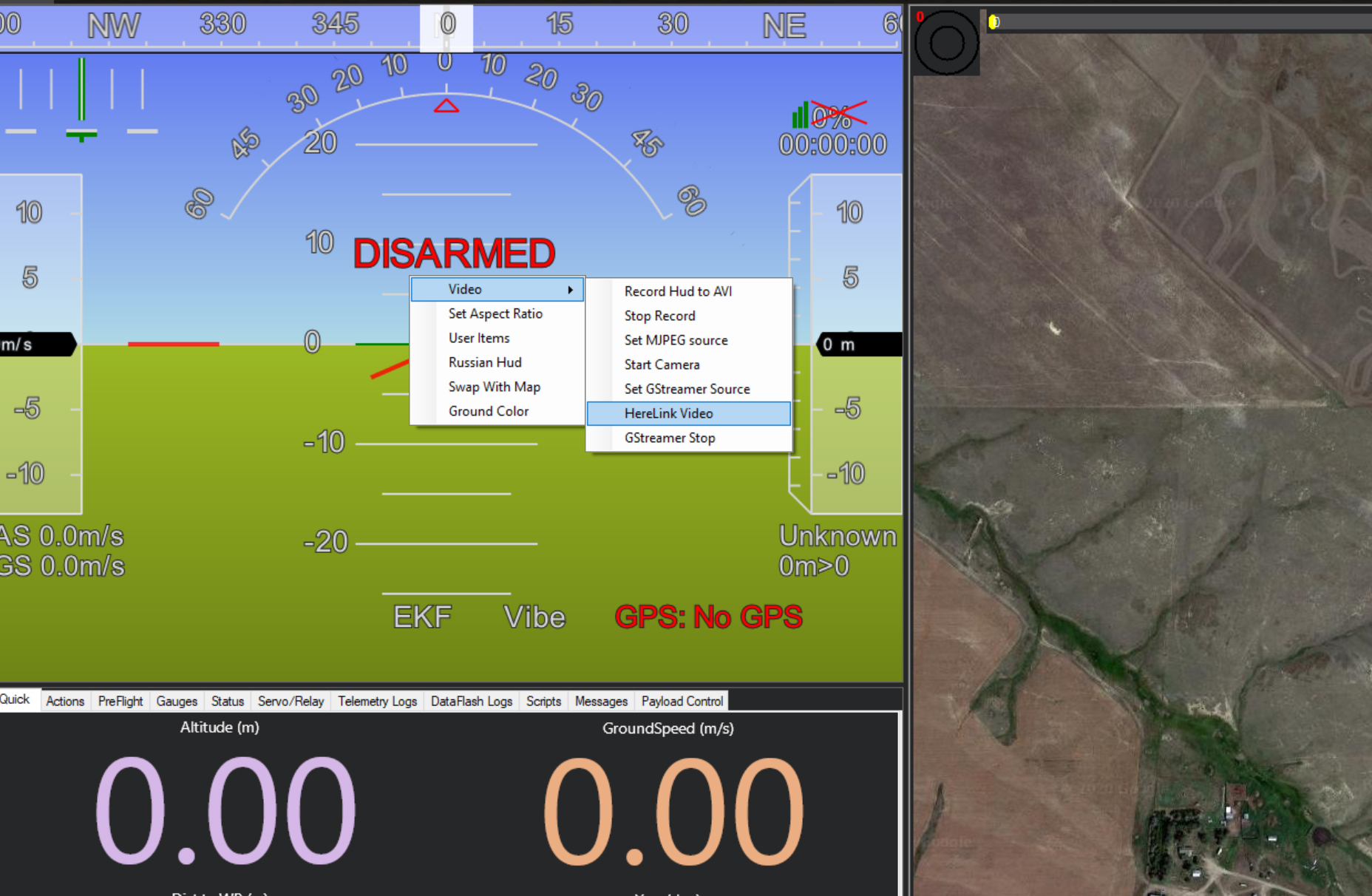

Thanks Julien, much appreciated! Was able to get everything to connect except for Video to be displayed on MP.
In Mission planner right click on the HUD > Video > Herelink Video > Enter Herelink ip > click enter
It requires MP 1.3.70 beta or above
A kind of tablet computer would be a good option as Herelink companion
Unable to see a Video tab option on the HUD for MP 1.3.8 or 1.3.9 beta, but am able to on MP 1.3.7??
With the latest MP you should have an option called Herelink Video when you right click and under Video ?
  • Right click the HUD
  • Select ‘Video’
  • Select ‘Herelink Video’
  • The first time you do this Mission Planner may need to download the files required to play the video. Your device will require and internet connection to be able to do this, you may need to disconnect from the Herelink hotspot to perform this step
  • A popup window will open, enter the same IP as you did in the mavlink step and click OK
Hey Ian,
So on MP 1.3.7, I see the video menu but when I click HereLink video, it does not do anything. I do not get the prompt that I should. I removed MP and downloaded again, but still not getting the prompt. Tried this both with HereLink connected to PC and without.
With MP 1.3.8 and 1.3.9 I am not even seeing the video tab in the HUD.
