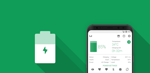

Regarding the overtemperature shutdown. I installed in the herelink this application:
With this is possible to set an alarm for battery and CPU temperature. I thing such an application should be always integrated in the herelink base image. Are you thinking about something in this direction?
