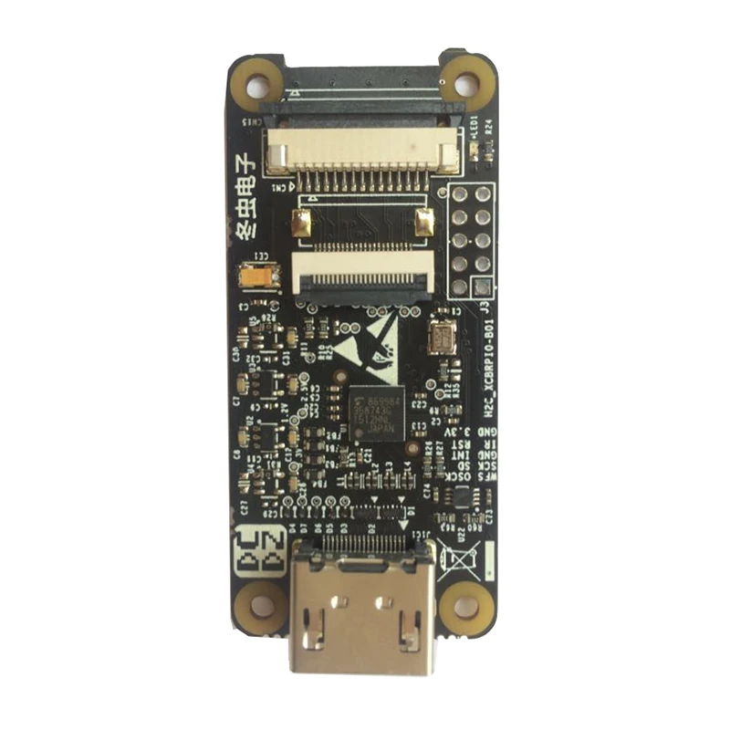

Maybe this adapter and a raspberry pi is a solution (if they have overcome this restriction: HxDMI input: 1080p25 only (software limitation at this time)) which weights less than 50g:
https://auvidea.eu/b101-hdmi-to-csi-2-bridge-15-pin-fpc/
or this
The second one fits on a zero and if you run is with gstreamer and hardware acceleration it should work fairly well.
