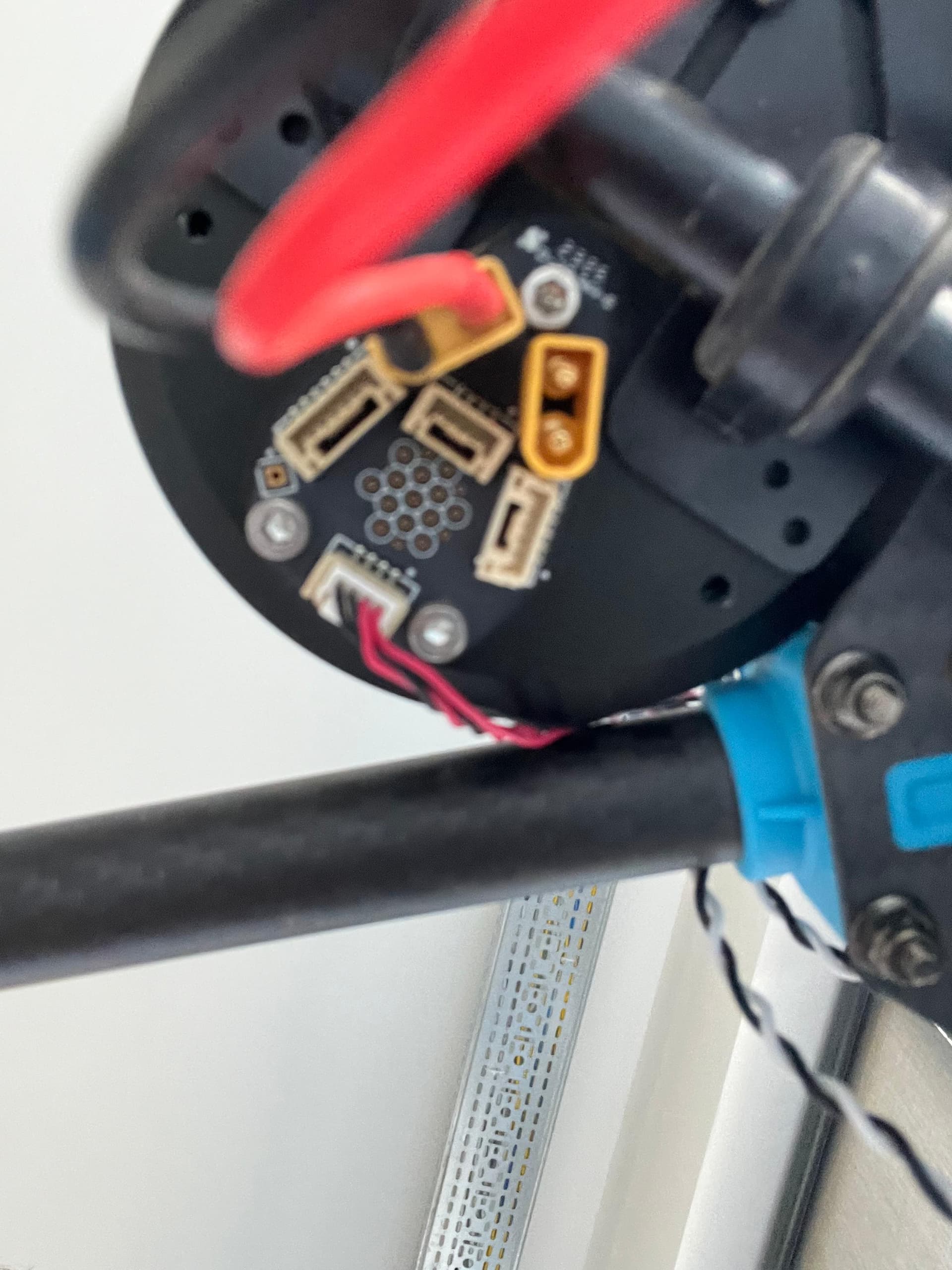

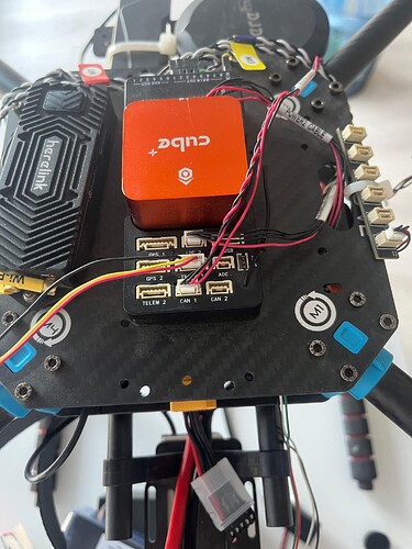

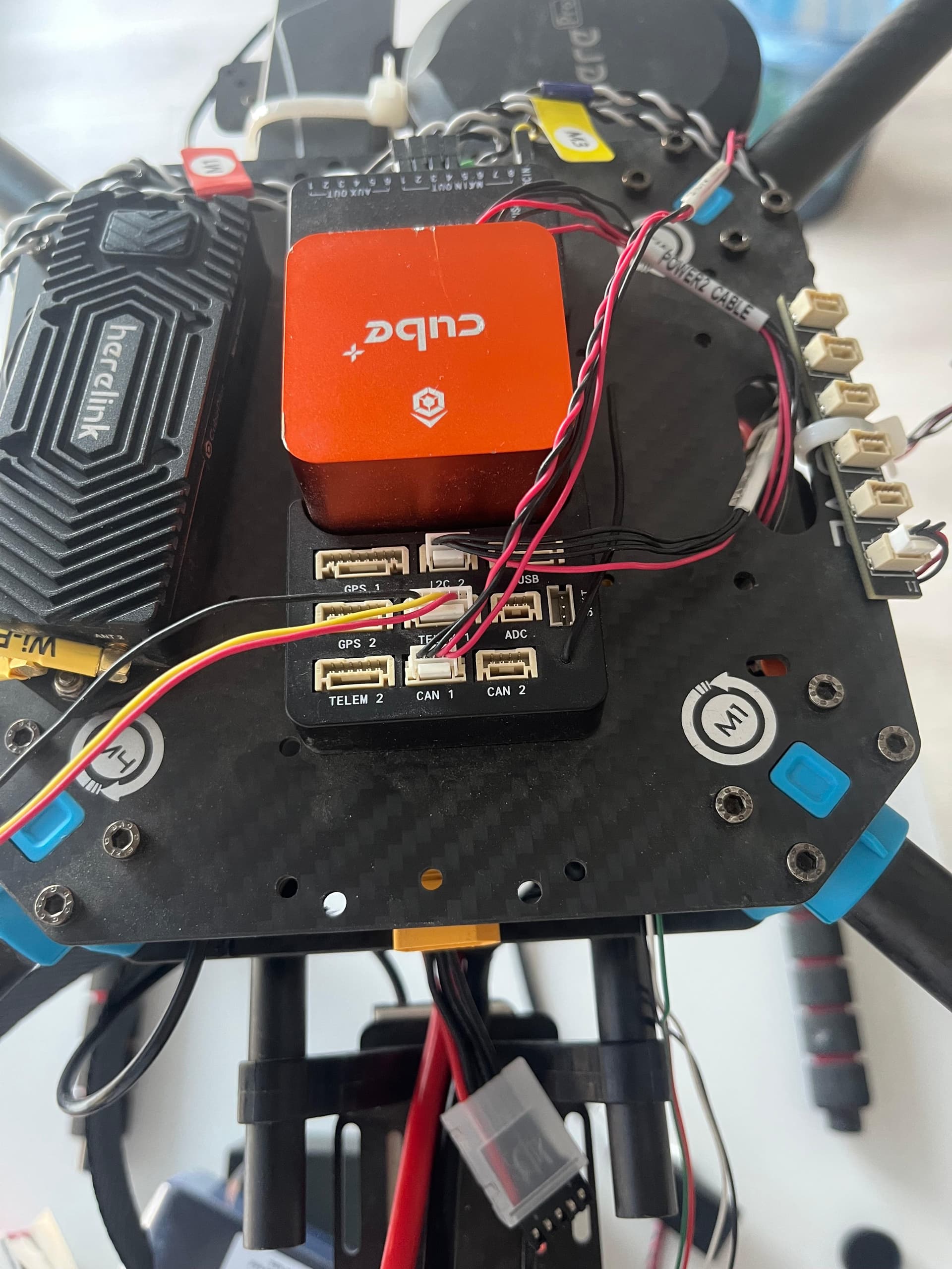

Herepro connected to cube orange with can1. (4 pin can cable)
