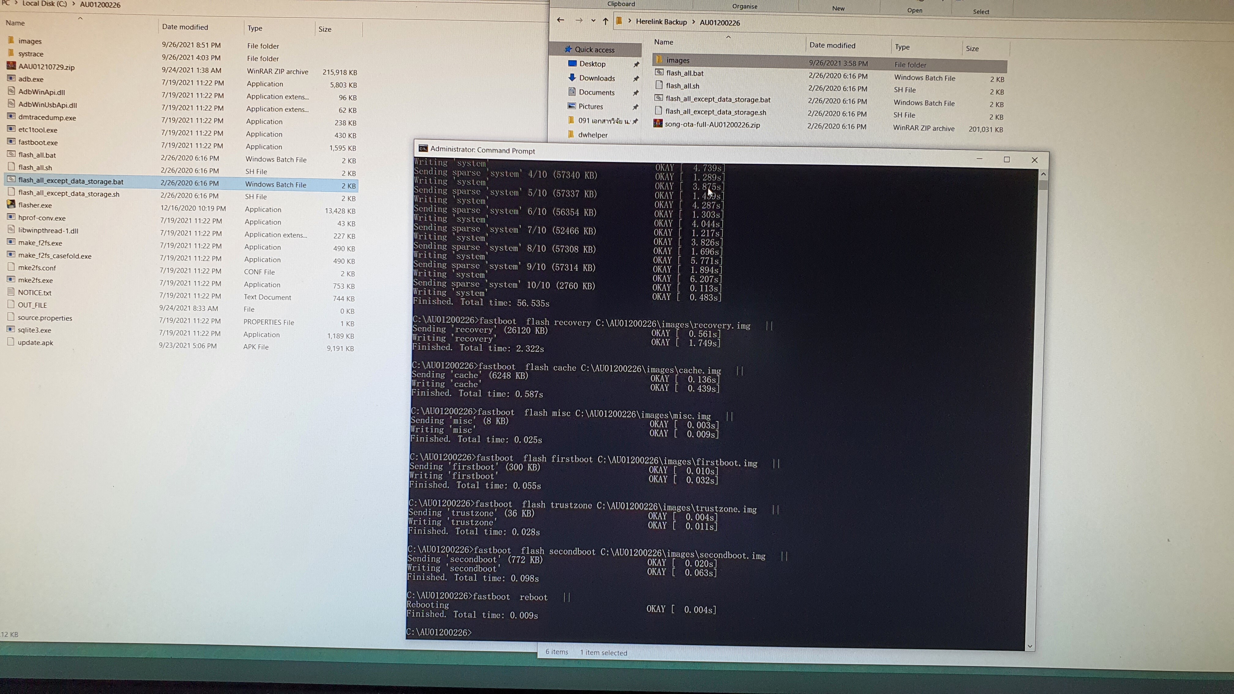

Now, I found the old version of air unit firmware (AU01200226) on the internet that still downloadable. I could flash successful by manual flash via cmd (fastboot>>flash_all.bat) and could not use flasher.exe yet as shown in the pic. Then the LED2 back to lit but still cannot pair with controller. So, please give me the latest air unit firmware set as the old version (Pic 2).
