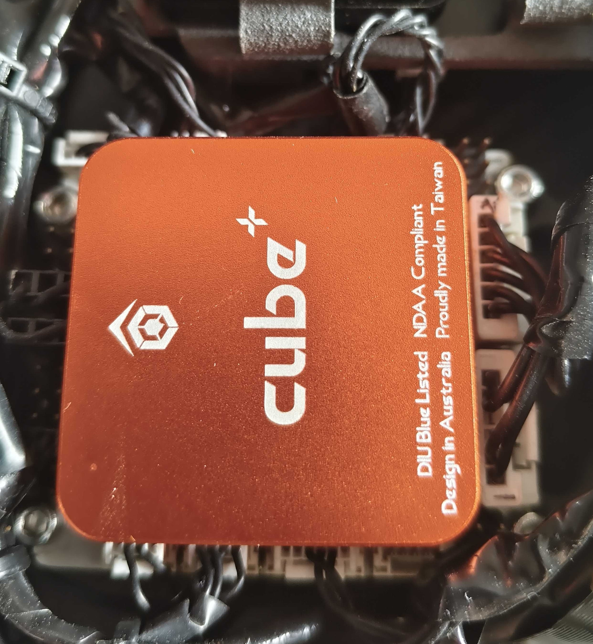

Do you also have pictures of the drones and the mount locations?
Hi Joshua,
Sorry for late reply!
Here we are sharing one of the picture of mounting cube in drone.
As we are in apart of certification and Stage 2, other cube mounting picture can be shared.
Actually as I said before we tested same cube in different drones with same mounting positions.
Please help us in find thing the solution for this, as it is very recently brought cube.
Do you have pictures of the wider installation? How thick is the plate that it’s mounted on? How much structure is in place to prevent movement and flexing in the z axis near the mount location?
